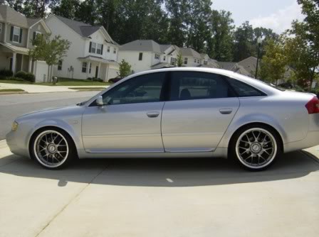

most people don't do staggered setups on awd.My understanding is the don't handle worth a crap . I'm running 19x8.5 all around. I know some people that have 9.5 but know how the clearance is. Pic of mineName:  HPIM2008.jpg

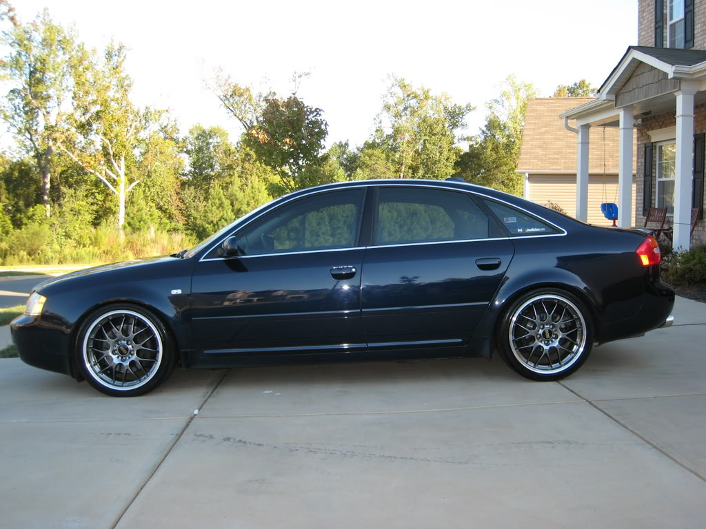

Any AUDI enginerr will tell you to not go stagerred, if you stay within the same wheel diameter _/+3%, you should not damage anything but it will handle WORSE stagerred.. however most people drive their A6 5/10's to 7/10's and won't really notice.
I know pople have fit 9.5 in the back... I have 19X8.5.
Like Capachinoo I always recommend the STAGERRED look like the Axis Decade with Maxxis lip. Looks greta like a staggered setup.
here's mine
