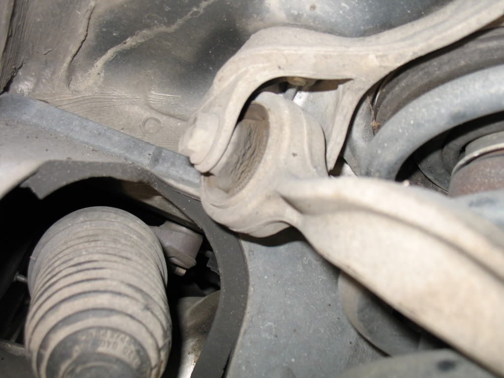

i did find dryrot in all of the rubber on each control arm and I get a very wee little kink in one of the driver side upper control arms. The tires do not move an inch in any damn direction. So I guess I need control arms anyway seems like a good place to start.
This car is making me nuts, look I'm talking to myself on line. I need another beer.
Has anyone ever done the bushings in there old arms? I don't have it left in me to try but I was thinking of spraying them with liquid CO2 and freezing the aluminum to -180 then pressing them out and in. Something tells me I would be wishing I spend the 5 bills.
here is the damage;
here is the damage;

Seeing how the bushings are cracked and torn I have to do the kit anyway. What do you think about those kits. Think it's worth trying the one for $320. Or should I just stick with the blau kit? anyone use any of those kits?
Meyle and Febi make the best suspension replacement control arm kits. Others seem to have crappy bushings which is where the problem is in the first place. I always use the Meyle kits myself.
The upper links won't cause a wheel vibration, but you will however hear a loud clunk when turning because the link will flop around like a fish and smack the strut tower housing or the springs.
Lower links can cause loose steering if the bushings are bad enough, but most steering issues come from the tie rod end links.

Jack, why don't you buy just a "Bushing Kit" from Blau or elsewhere?
Blau has a sale on bushing kits right now - Front only though - for $ 69.95.
http://www.blauparts.com/proddetail....od=MA21032%2DC
I never changed bushings, but it seems that are not that difficult to replace since they have a metallic outer edge. Don't they just slide or are tapped into the arm's holes?
If your arms themselves are not cracked, why wasting extra money to buy new ones?
