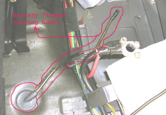

Anyway, when I took the battery out, I noticed a slim hose sort of propped against the battery. I forgot to take a pic, but I had a chance today since it was a bit sunny and was able to pop out the sunvisors' clips I was dieing to do (about that in a different topic).
And a closer look:
Is that indeed a "venting" hose for the battery? If that's the case, the battery probably was replaced before I bought the car, and the model doesn't have a "plugging" place for it. (Although from what I recall over the years, I never seen a "vented" battery per se). By the same token, if the hose is for venting potential acid fumes, does it just suppose to collect them out from the air?
Conversely, if it isn't for venting the potential acid fumes from the battery, do you have any idea what it could be placed there for? I see nothing that would resemble in the slightest form like a place where that hose should (or could) be connected to.
And a closer look:
Thanks again guys.
German cars seem to all have the vent line. Must be a German law or something. The vent actually vents hydrogen gas that is a byproduct of the battery discharging. Maybe they remember the Hindenberg.....
