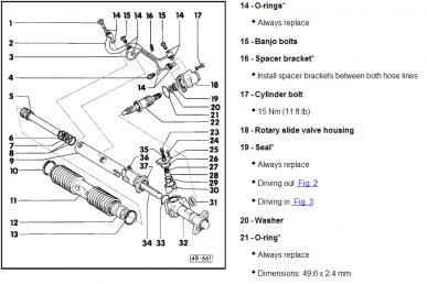

Apparently it has some adjusting bolts that you should be able to get to.

You're very welcome. Since the adjusting bolt(s) is(are) off the boot, you should be able to locate it easily.
I'm not familiar with a quattro and 30v engine bay (just know they're pretty crammed from pics, as compared with a 12v), but on mine I have to take the air intake box/throttle body off to get to the rack.

A 98 is a C5, not a C4. There are no adjustable bolts. There are two attaching bolts under the battery and three up near the worm gear area of the rack that you have to get to from below. They are attachment bolts and are not adjustable. But, that doesn't mean they aren't loose.

I know 98 is a C5...The illustrations come FROM BENTLEY, Bob, although it's true that's listed under "Avant 1998, AFC". Don't both (Avant and sedan) share the same engine bay for a particular year? - ....don't shoot the messenger...
