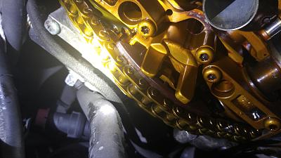

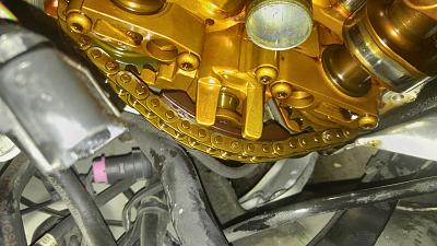

So some progress on my project. I took the valve covers out and noticed that the plastic piece on the left side cam chain tensioner was missing and the chain had been rubbing on bare metal. There are some marks on the chain but I'm not sure if that means I need to replace it. Also as I was pulling out the ignition coils, 2 of them on the right came out without the rubber piece, I'll try to attach pictures to explain better. There was also some deposit on the valve covers.
Pictures are clear and I see what you are mentioning.
While you are at it and doing all this work I would replace it. The chain is cheaper than he tensioner!

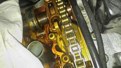

I started taking stuff apart over the weekend, didn't get as far as i wanted due to the holiday but i did run into some issues(hopefully visible in the pics). When i took the timing belt covers off i found the belt to be a bit loose, i could wiggle it with my finger. I'd also like some advice on whether i should do the timing belt first then do the cam chain tensioners or vise versa. I DO NOT want to mess the timing on this thing.

The belt should be very tight. I've seen the tensioner fail - especially if the last person who did the job decided to be cheap and compress the tensioner instead of buying a new one. There are several posts mentioning that these tensioners can be compressed but about half of the time they don't like it, start leaking and either fail while driving or loosen up to where the belt is not tight. I recommend always buying a new one.
As for which order to start this with:
I've not had to play around with the cams too much when I worked on this so I'm not sure how much wiggle room you have to remove and replace the cam tensioner. From the sounds of it though I would do the cam tensioner first while leaving the timing belt on so that timing doesn't get messed up. When done start marking the cams, remove the belt, remove old timing belt tensioner, replace any pulleys that need replacing, install tensioner (but don't pull the pin yet), install the timing belt and make sure all is well and aligned - then release the pin on the tensioner.
