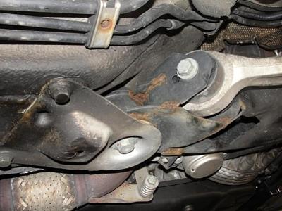

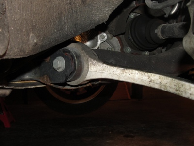

So I'm wondering, can I release the rear lower control arm from the chassis and get the axle to swing out of the way? (See pictures) This is my last resort before either ordering the tool or heading to the local mechanic.
Any help is greatly appreciated.

Yes, you can (and should!!!) remove the lower control arms from the chassis. That is the fastest way of getting this job done.
Now, tough question, didn't you search on this before starting? I have answered this question many times before and am curious why it didn't come up in a simple search.
Good luck,
Bob

I've searched and read (over 20 hrs easily) so I immediately recognized your name Bob! Oddly, though in all my searches, what I came up with was removing it from the knuckle. I had not come up with removing just the chassis side and repairing the boot.
That said, (your vote of yes is huge!). I want to make sure I can get the bolt free from the chassis, which requires lowering the rear sub frame. I've read that I can lower it by 1inch and should be able to get the bolt out from there. Does that sound right? Also, "lowering the rear sub frame" just sounds scarey, but I assume it's not an issue to go down 1 inch? Can it be completely removed if needed? I've attached a picture that shows the 3 bolts to unscrew.

One one side, you have to lower the rear of the sub-frame about an inch. It's a piece of cake.
Forget the seperator, you won't need it. You WILL have to remove the tie rod end from the knuckle to get enough rotation to get the end of the axle past the bearing pack. Remove the through bolt (which can be troublesome like the pinch bolt), loosen the top bolt and tap on it, loosen some more, tap some more, etc. until the bolt is out then whack on the tie rod end and it will come out.
Not sure about an '05 All Road, but I would bet, yes, the technique would be the same.
Good luck,
Bob

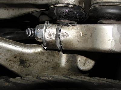

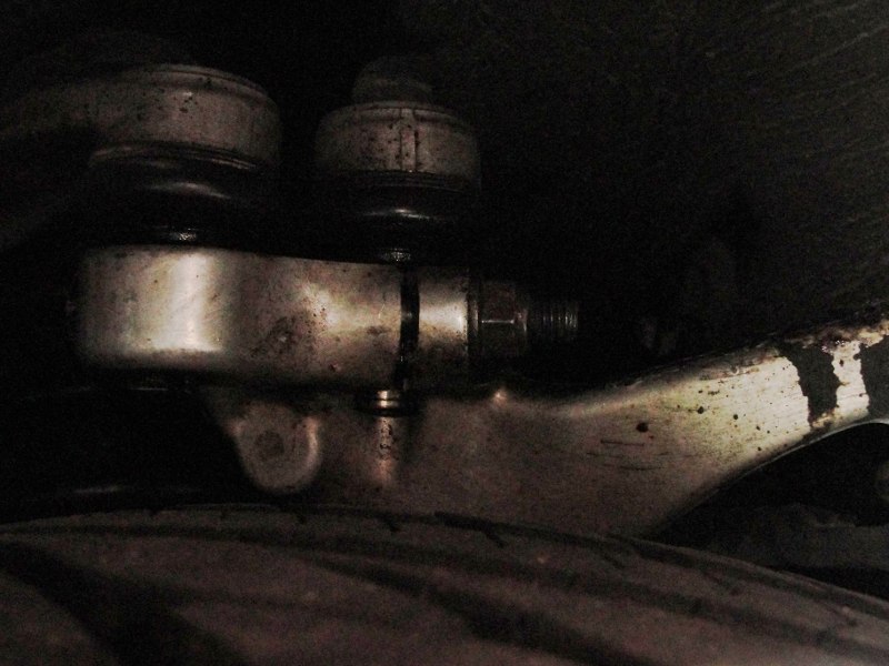

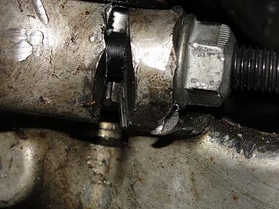

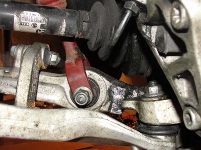

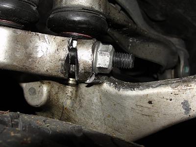

So I decided to give it up the local mechanic (non Audi dealer). However, I'm not sure that was the best idea. They removed the pinch bolts, but ended up cutting the knuckles up fairly bad in the process. I have included the pictures below. My concern is safety. Can you please review the pictures and let me know what you think?
The driver's side is considerably more damaged. You'll also notice in the pictures that they cut the control arm pin that is held by the pinch bolt. They also cut the boot of the upper control arm on the passenger side.

My advice:
Never ever go back to that so called "mechanic".
Regarding safety: I can't tell you how safe your ride is now but I wouldn't trust it until you replace that control arm on both sides. I also wouldn't consider bringing that car back to them to fix it, who knows what they cut or damage in the process of "fixing" this.

The "local" mechanic is a national chain so you would think it wouldn't be an issue. So would you replace the upright on both sides plus control arms? I'm guessing this is a $1k repair?
Old May 21, 2011 | 09:49 PM
ATSAutomotive's Avatar
Joined: May 2011
Posts: 11
As a shop owner, I can't believe they did that. Did they even speak to you before doing the cutting? There are suspension systems that use a pinch method like that, but Audi did not design them in this manner. Seeing as you are a new father. I just simply wouldn't trust having my child in the car with modification like that. Looks like they are the aluminum uprights as well, just a bit more expensive. Call Bryan at Tullin Concepts, he should be able to get you the uprights and control arms. You can buy a control arm kit off ebay for around $300, comes with tie rods, control arms, etc.
