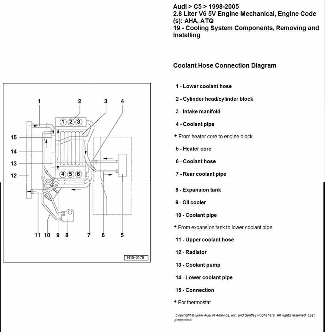

Here are some updates. Here are some more things I found out.
1. Radiator gets hot after running for a while.
2. Fan clutch is gone. I can stop the fan with a roll of newspaper very easily.
3. Interesting point here is that the little water hoses that go to the coolant tank get hot. However, the large hose that goes from what I think is the water pump to the radiator does not get as hot. It was a tepid warm at most. Water temperature on the gauge is over half.
Anyone can help?
Is it the water pump?
Which direction does the water flow through the radiator?
Could it be a clogged radiator?
That that hose carry coolant from or to the engine block?

Based on the fact that you're seeing coolant bubble / boil and having to add coolant, there is no flow from your coolant system. The liquid is sitting stagnant and is boiling and evaporating through the overflow port in the expansion tank. This can be due to a thermostat stuck closed, or a water pump that has separated from the impellers.
