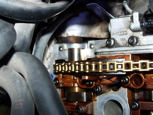

You guys are quick tonight! I'm going to ponder this one 2nite. I'm currently not working on Fridays, so tomorrow is going to be a garage day. Here's a pic of the surface I'm talking about:
You can see the end of the cam, the two locating pins for the cap, and the machined surface around the locating pins, one side is inside the engine, the other out. The valve cover goes up and over the cap, but what seals this surface between the cap and the head. I DON'T want this to leak again soon, as I can't afford the beer required to spend another week in the garage

This is what I used on my gaskets, at those corners similar to the arrows Jack pointed out at. Those where the only points where I dabbed a thin film. For the rest of the surface I spread a thin layer of oil.
I bought it from Arizona Autohaus at the same time when I ordered the parts for TB replacement. I also used it for the WP, and for the coolant O-ring seals I replaced (back of the cyl heads + back of the T-stat and WP housings)
If you are too concerned with not trusting the "ermetic" fitting of the gasket, then you can use sealant in between the cover's matting channel itself and the gasket. Don't go bezerk and use a lot, though.
As Jack said, probably the reason they start leaking is due to becoming brittle with age.

Found it!
Manual says:
Lightly coat last bearing cap (after the chain) with sealant D 454 300 A2 before installing. I'm going to the local VW dealer, see if they have the right stuff. If no, it's a skim of rtv black she'll be getting. I'm kinda hung up anyway until my cam adjuster tool 3366 comes, so I've started work on the drivers side. Thanks for the help everyone, this forum rocks.
Gary
Manual says:
Gary
Well, looks like it's going together with RTV black. Called the dealer, they want $122 for the tube of special D 454 300 A2 sealant. I insisted I only needed a tube, not a case, we had a chuckle, and I said no thank you. Wow.
