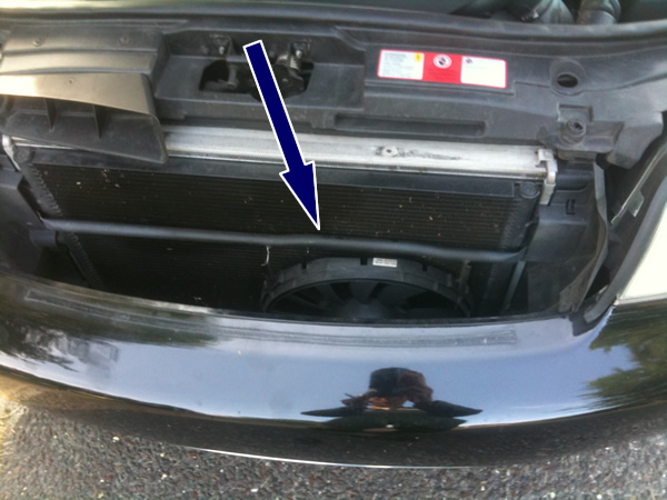

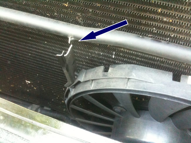

Apparently I did a super bad job of spotting this when I looked earlier.
I found this fan with it broken off from the bracket.
Now the problem is that I need to identify what parts I need and where to get them. I don't have a Bently Manual, so if anyone would be so kind as to look up the part numbers for the fan and the bracket, that would be awesome.
