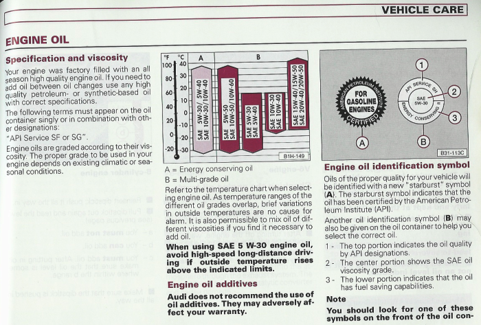

* If the temperature never drops below 5°F, but you get often enough temperatures over 100°F, you should go with a more viscous oil:
15W-40; 15W-50; 20W-40; 20W-50.
* If the temperature is very seldom in the 95°-100°F range, then you can go with any of the following:
5W-30; 5W-40; 10W-30; 10W-40.
Nevertheless, whatever oil you decide to use should carry the "API Service SF or SG" specification.

Old 03-04-2009, 06:47 PM
chefro's Avatar
Join Date: Dec 2008
Location: IL
Posts: 1,941
