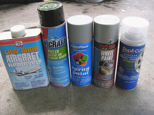

Supplies:

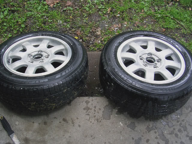

Cleaning - diluted PurplePower (it works miracles):

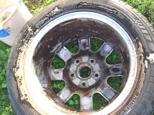

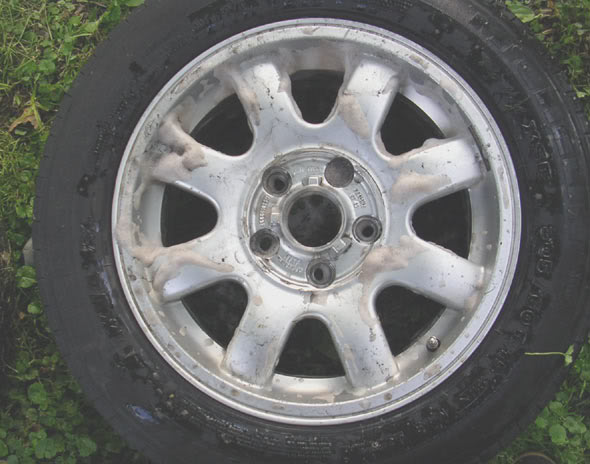

Applied AircraftRemover goop:

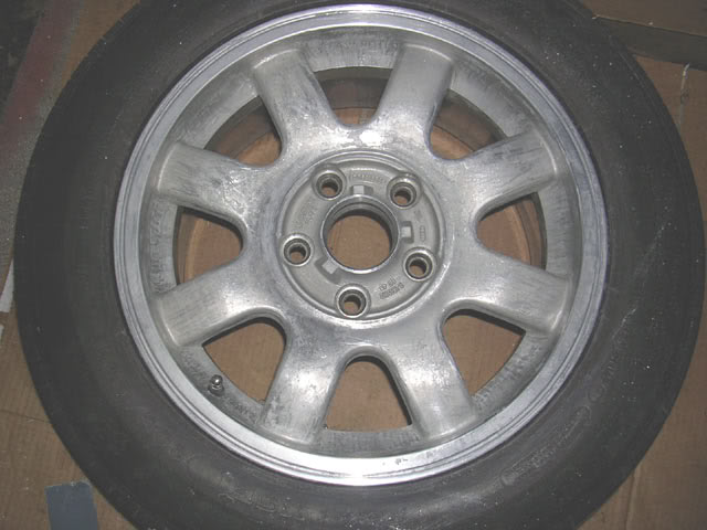

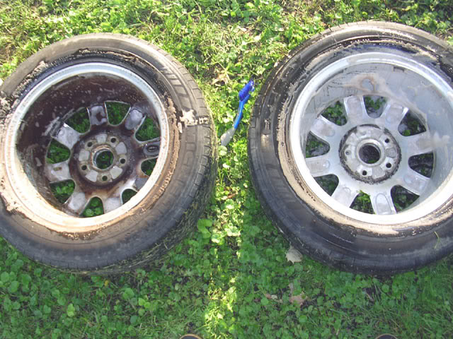

Removed all the drbris all the way down to bare aluminum:

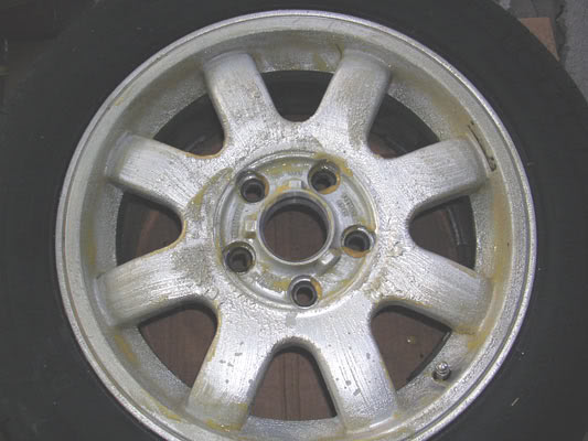

Cleaned up the wheels:

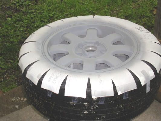

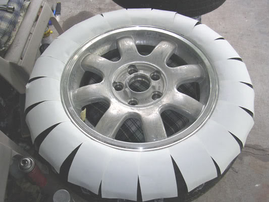

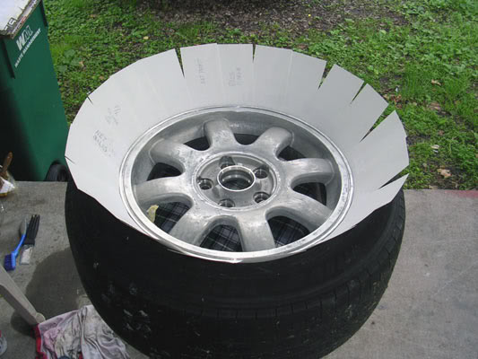

Masked the rubber;I started with this:

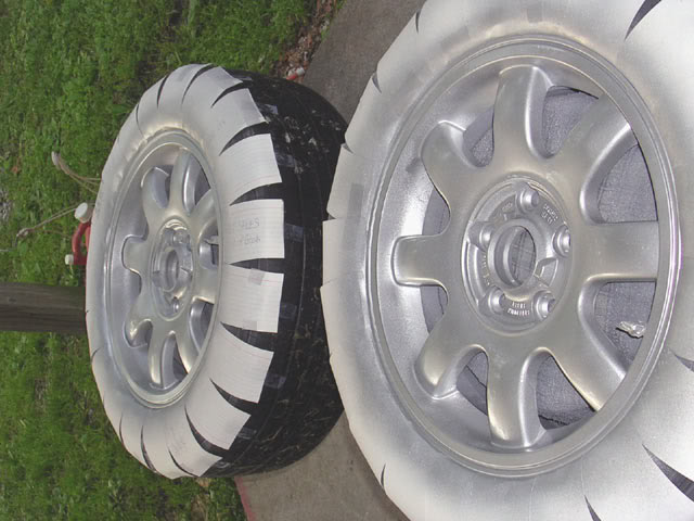

but it was a darn windy day, so it kept knocking off my index cards. I ended up with this setup:

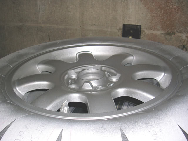

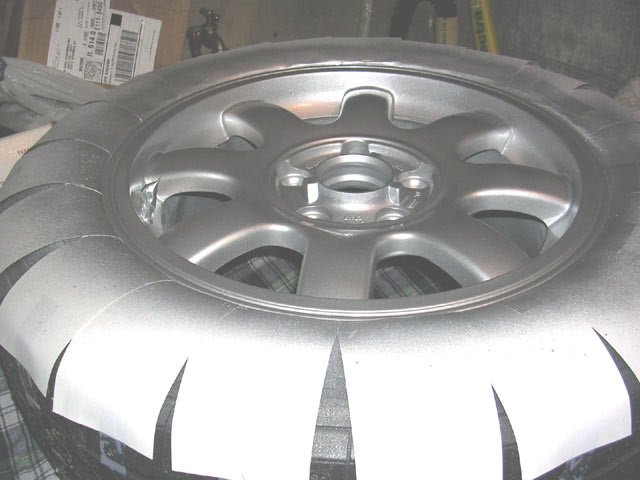

Gray Primer:
First coat:
Second coat:

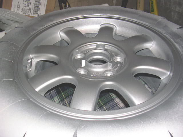

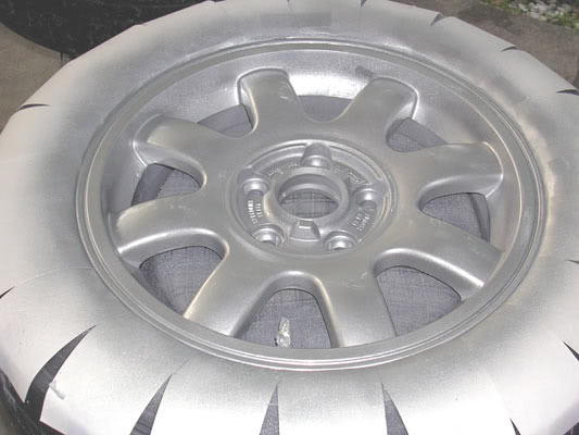

Paint:
First coat:
Second coat:
Final coat:

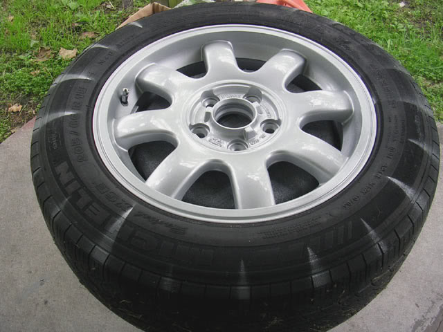

Clearcoat - I used only 2 coats (got sick of painting):
Look before:

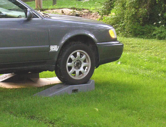

Look after:
Got two more wheels to go.
I know it doesn;t look professional, or factory-like, but it is an improvement from the sore-eye the wheels used to look like.
Oh....and it surely beats spending hundreds or thousands on aftermarket fancy wheels, or worrying about offsets, spacers, fender rubbing, etc
