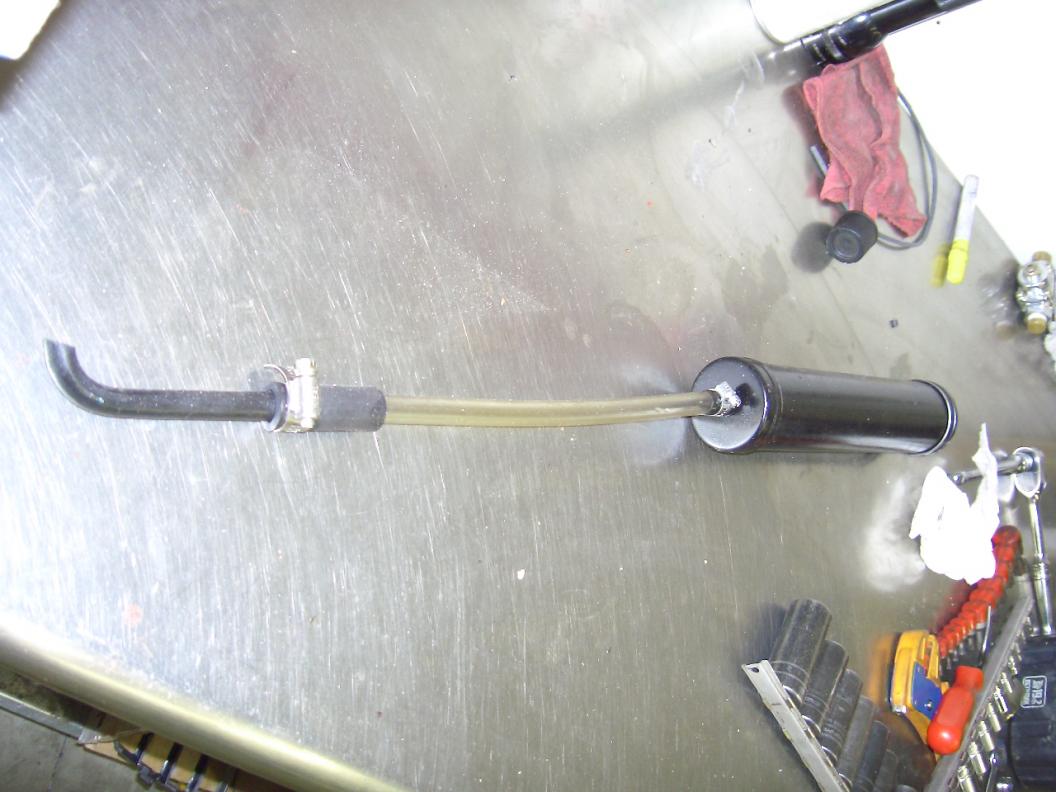

The transmission filter is inside the pan, bolted to the valve body.
No special tools are needed save something to fill the mess with (and I do mean mess). A suction gun works well if you have a 90 degree tube on the end. (see picture) Just fill the trans before starting and quickly add the rest as it is running. Then monitor the temp and top it off. You can monitor the temp with a proper scan tool or with an infared temp gun on the pan.
Be sure to have extra fluid on hand for spills and leakage. 2 quarts ought to do.
