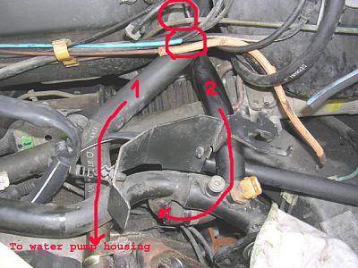

It's actually pretty simple. Run the engine until hot and locate the heater core valve bleeder (you need to take the cowl off). Unscrew gently 2-3 turns. You should get a steady stream of coolant. You'll get steam escaping - which is ok. If you get fizzing, hissing, gurgling, it means you have air in the system. Screw back and then repeat several times until you get a steady flow.
Next step is to loosen the main rear pipe bleeder. You need to locate it first and leave in it a socket + extension + rathcet - is like a 5 or 6 Allen (metric).
You should be able to find it close by the coolant temp sensor - you see it on the coolant line in the photo.
I include a pic so you know what you're looking for.
(By the way, if you follow hose labeled number 1 (in the pic) through the firewall you should find the heater clore plastic bleeder.
Don't forget to top off with coolant after you get done.
Attached Thumbnails Why does my car take forever to heat up?  1995 with 2.8L-heater-hoses.jpg
