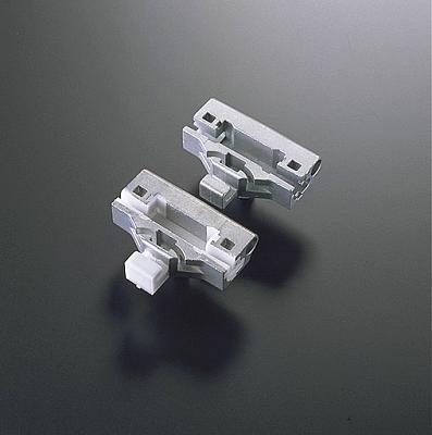

Default look at this ! :)
well, call 480-966-3040 EXT 239 and ask for Audi A6 window guide clips. $10.00 each
here is a step by step, how to do it I done it mine with same manual
http://www.audiworld.com/tech/int45.shtml
Attached Thumbnails Window regulator repair-audi%2520-%2520window%2520lifting%2520mechanism%2520for%2520audi%252080_2404.jpg

I bought the guides today and installed them. Once again, I really need to get a repair manual for this car. People always told me that German cars are weird, and they're right. That was the most awkward window I've ever removed. The whole frame came out! I don't think I'd have finished the job tonight without that walk-through. Anyways, you were right, and the guides fixed the problem. Kind of annoying when $20 and a little effort can save a lot of hassle with that stupid window.
Here are some pics of that little broken plastic piece that causes such a headache:
