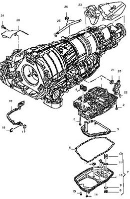

My only other query is that I had tried to source the TCU location previously (hence wanting to make that it was defintely right!!). An independent supplier for Audi printed off the attached image for me from ETKA (number 1 on image)? The part number they gave me was 4E0910156F (& 092927156 for hardware). On their system, this shows up as a 'mechatronic' unit? This confused me a little as the name reference is usually the same/similar to the part you're looking for, but nothing else showed up! It aslo seems to indicate it sitting directly under the gearbox?!?!?!!?!?!

.My only other query is that I had tried to source the TCU location previously (hence wanting to make that it was defintely right!!). An independent supplier for Audi printed off the attached image for me from ETKA (number 1 on image)? The part number they gave me was 4E0910156F (& 092927156 for hardware). On their system, this shows up as a 'mechatronic' unit? This confused me a little as the name reference is usually the same/similar to the part you're looking for, but nothing else showed up! It aslo seems to indicate it sitting directly under the gearbox?!?!?!!?!?!
Again, any clarifications on this would be greatly appreciated.
Had a look last night - there is a black box in the passenger side footwell (under the carpet), but this contains a Motorola control unit for the telephone. Looks like the TCU may well be as per the diagram, unless elsewhere?
If its not under the passenger's foot well it is located in the gearbox. I haven't had to deal with any TCU's from a D2 A8 so i assumed it was in the same location as every other tiptronic trans. The CVT trans also has the TCU built into the gear box. Kind of a pain in the butt now. If its not communicating and its located in the trans i would say fluid leaked into the unit.
