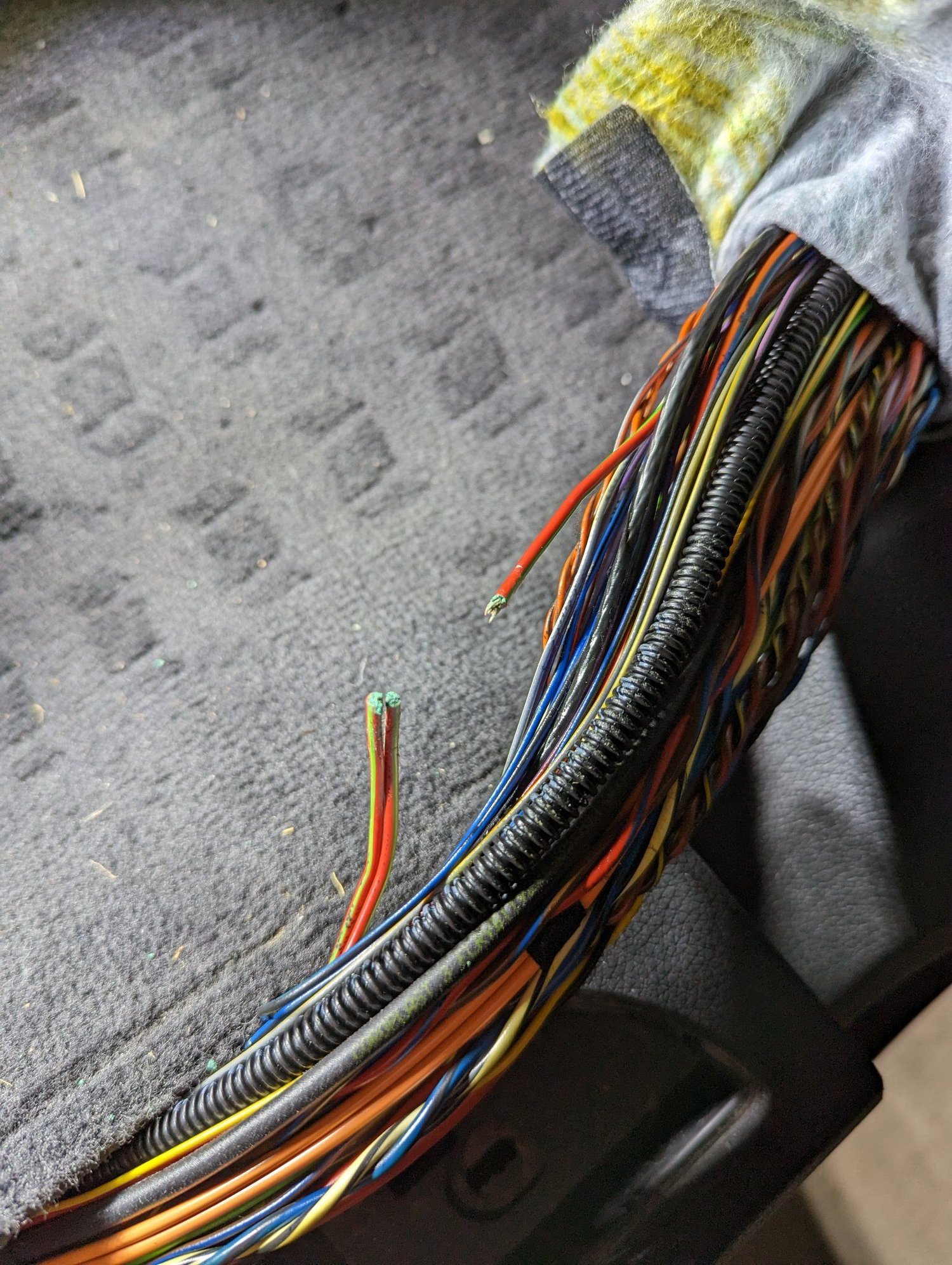

Default Problem solved!
For anyone else that stumbles across this with a similar issue, I managed to figure this one out with a little help from a youtube video:
That individual was getting the same codes (01316 - ABS Control Module, 013 - Check DTC Memory - Intermittent and 01315 - Transmission Control Module, 004 - No Signal/Communication - Intermittent) and found that he had water leaking on the passenger side from the AC. The water had corroded a connection between three wires in a harness that runs under the carpet on the right-side of the passenger footwell.
I removed the passenger seat, the metal bracket that it sits on, and popped the plastic trim loose along the bottom edge of the door frame. I pulled up the edge of the carpet (I did not have to pull it all the way out) and it was fairly dry underneath but did have a hint of dampness. The wiring harness runs though a cable tray which I had to pop open. I then cut the zip tie at the forward end of the tray and unwrapped the fabric wrap from around the harness for 6 inches or so until I found the two wires that join into one. Sure enough, when I removed the black wrap from them they were very corroded and basically fell apart.
I cut the wires back until there was no evidence of corrosion and the copper looked new. I spliced in a new piece of wire and soldered and sealed the connections. I cleared the codes and drove the car and the issue is resolved! It shifts perfectly again and no codes came back. I am relieved as I was beginning to suspect a problem with the transmission valve body and/or solenoids which was going to be a difficult and expensive fix. Fortunately this was relatively easy. Now I just have to figure out how to clear out the AC condensation drain so it doesn't keep leaking!
