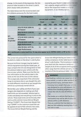

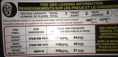

Hi,
I am trying to figure out the optimum Tyre pressure settings for my new vehicle under normal load condition.
Recommended Tyre Pressure - Q7 - 2013 as per sticker (full load)
44 PSI - FRONT
49 PSI - REAR
Size: 275/45 R20 110 H
Would there be any associated risks by not following the recommended settings as per the door sticker. I have attached the door sticker and user manual recommendations.
I have decided to stick to 35 for both the front and the rear.
Thanks!
Attached Thumbnails Recommended Tyre Pressure Q7 2013 - AUDI-photo1.jpg   Recommended Tyre Pressure Q7 2013 - AUDI-q_7_tyre_pressure_manual.jpg

Out of curiosity, why are you deviating from the MFG recommendation? Performance, traction, tire wear?
