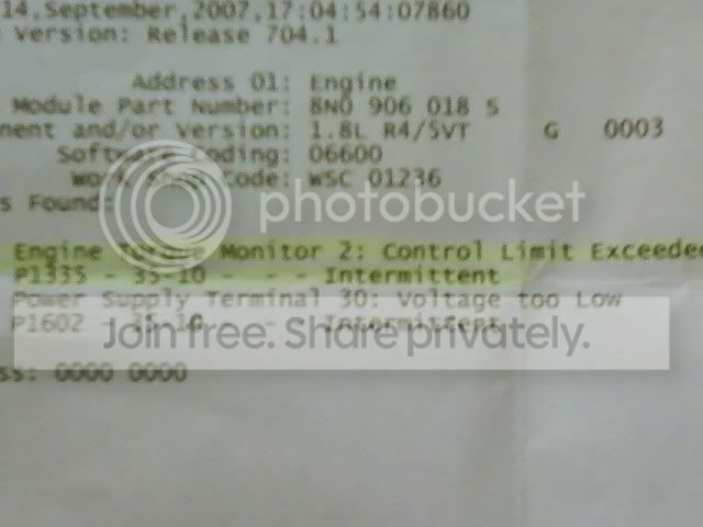

So between last night and this afternoon I've hit limp 4 TIMES!!!
I completely removed my boost gauge, which was hooked up thru my DV, and put my car back to stock (last night).
Well as stock as it can be with the flash.
This is frustrating as all hell! It's not your typical limp either.
Car will just drop to 1000 RPMS, non-responsive to the gas peddle and that wonderful EPC light.
Oh, and let's not forget this wonderful turbo whine I started hearing on my way home...

Just got back from AWE Tuning.
Yes I'm sure I hooked everything back up to stock... shesh it was only a vac line!
I removed the boost gauge because I thought I had a boost leak...
Well guess what none of the above! On my way up there I finally thru my first CEL!!
I'm very excited about this by the way!
According to the manual I need to check my IAT sensor for DTC P1335.
Apparently this is a dealer only part... friggin sensors!
They reset my CEL's and she runs perfect!
So I'll order the sensor and wait to throw it again to replace it. This had nothing to do with the flash, so I'm told.
