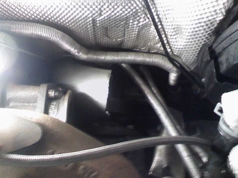

Let me know if you want to buy a never used but installed Oil Return line for the PAG manifold. Also, if you have Quattro, I wouldn't get the Pag manifold.
Old Jan 27, 2008 | 12:31 AM
rayveedub's Avatar
Joined: May 2005
Posts: 1,153
From: Baltimore MD
Default RE: buying the GT2871R....
why not?
Old Jan 27, 2008 | 12:45 AM
Tylor's Avatar
Joined: Aug 2007
Posts: 23
ORIGINAL: rayveedub
why not?
Sorry, I should have said if you're going to, definitely get Arnold to fabricate the downpipe for you. The set-up I tried to run was the manifold, 2871r, and his Vband adapter. I mention that just in case the vband adapter was the reason for it not having enough room. Below is a crappy pic I took with my phone. Here you can see the vband adapter, and the thing above it is a 3" pipe. The other end of that pipe is connected to my exhaust, and it makes a 90 degree turn as soon as it can. There just isn't enough room for it to make a 180 degree turn. It would have to make sort of a horseshoe shape and the pipe would have to be touching itself. Arnold did say that he could make me a downpipe for $400 but it would be "hacked up".

Pag sells ATP turbos? If you want to use your OEM manifold you need ATP's eliminator 2871r. The normal Garrett 2871r doesn't work like that.
