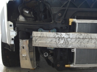

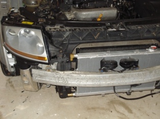

Here are some pics of the setup as it stands. Need to replace the pancake pipe and everything is pretty much a go. Should have the new peice very soon. However, my car is still fighting me to start so that takes priority . Anyways.... pics, and yes the light fits back in, just didnt feel like messing with it

GOOD NEWS EVERYBODY!!!
I think i may have found another core that will fit even better and lower the cost another $50 overall. The end tank is shaped a little different and will allow me to push the core back a tiny bit which will be nice. Its a win win.
Man im so stoked to get this up and running personally. If this works as i hope, people will only have to change one pipe, plus the core and rad are simple to mount. Should be far easier to install than completely changing every pipe from turbo to manifold since you have to line everything up just right. Not to mention the piping length is rather short

That one is the same as the above. I havent bought one yet but plan on using those since the entank is shaped better for the car. This will allow me to put the pipe replacing the pancake pipe up next to the plastic cover by the TB and more clearance for our bumpers. Should fit a mkiv really well since they have way more space down there than we do. You know you want one of these!

Little update. The larger core like the one shown above will fit, but im going to have to modify one of the end tanks so i can hopefully get it to fit w/o trimming the wheel well cover and maybe even connect it to the pancake pipe. At worst it should clear the wheel well cover or have minimum trimming.
I also just received a new smaller core that will slide right in to place and so far doesnt need any trimming. I will hopefully have that conclusion tonight if i dont get hit up by a crap load of trick or treaters! This core will be a perfect solution for those looking to either remain stock turbo or even go up to a 28rs or a mild 2871r on pump.
