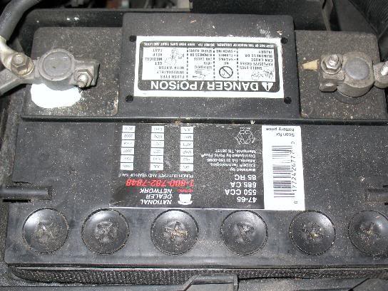

Alright, so I've been reading tons of posts on cold starts and such, trying to figure out my issue. One post recommended looking at the battery, so that's where I went. Could this be the cause of my cold start issues and lean fuel condition? I'm searching for help and can't figure it out. What should I do to fix this? Clean it off or new battery or ?

If its not the filter or the o2, then you most likely have a vac leak. The vac line to the fpr (fuel pressure regulator) is a problem spot and would mess with fuelling. Also i wold clear the code if you havent since you could of fixed it already and it just hasnt gone away yet

i had cold start issues and thought it might be the battery - turns out, I had a huge leak in the hose on top of the DV where the fitting tightens. it was worn right through! I also think my MAF was bad, so I replaced it with one that I thought was bad that I had swapped out 6 months ago... turns out - the old one wasnt bad, but the newer one was...

as far as a battery, optima makes the best **** out there. Yes they are expensive, but customer service and product warranty can't be beaten. I hit a dodge dually with my BT corrado and cracked the case. It was replaced for free. Not to mention, you can mount it any way you want (even upside down). As far as a way to diagnose your problem, take it to the dealership. Let them tell you what's wrong with it. They can't charge you for an estimate. Oh and, buy a liquid tt so you can clear your own codes.

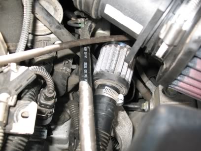

I did some more looking and trying stuff, and it seems that it only idles w/ less vacuum when this line is being used (the one w/ the white filter on it):
I'm thinking this is the secondary air pump line (?). When I ran the car for a bit, then shut it off, and re-started it, this line didn't seem to be doing anything and the car idle'd straight to 20hg. I THOUGHT I felt a small random burst of air around that line when the car was running, but couldn't re-find it (so I'm not sure if it actually was leaking from that line). I'm thinking there's something wrong in my secondary air pump system that could be causing this.

That white filter is the intake for the secondary air injection, that second pic is the other half of the system, turning to a steel line and running back to the exhaust.
A slightly lower reading is normal on cold start (17-18ish), and once warmed up, 20-22in-hg is normal.

Mine seems to not matter if I'm full on gas or not. I also believe I have some sort of battery issue, but not sure if the two could/would be related. This morning I went out and had to turn the key 8-10 times before it finally attempted to start. The first few times there were no sounds or nothing when I turned it. When it did start up, however, it started up and idle'd fine, even though it was cold this morning......???
