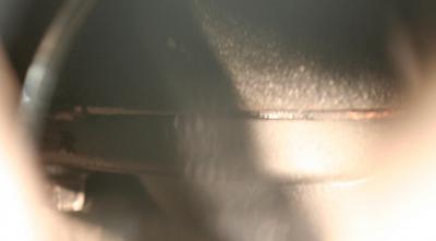

okay did more poking...with a mirror and can def see coolant at the bottom of the thermostat housing...and i was able to take a pic..i think the new housing i got is bad?!? or the o-ring too thick? or the whole thing isnt seated properly...please see attached pic notice the gap between the housing and the engine block...its about 2-3mm in the middle, but sits flush at the bolts is this normal (guessing not) and how do i fix it?
