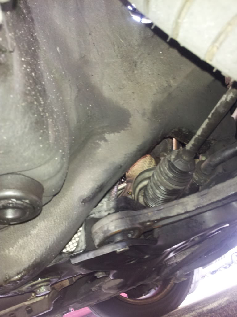

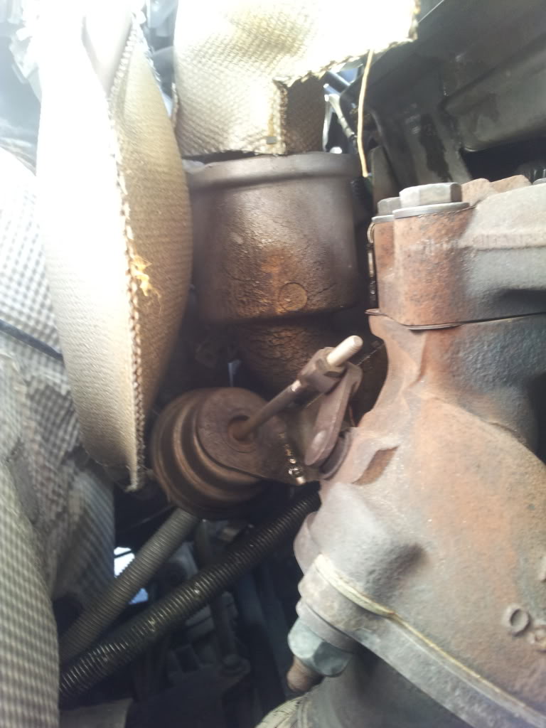

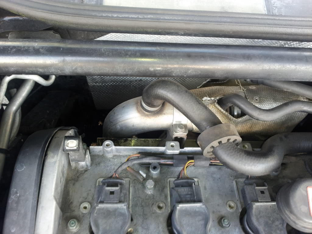

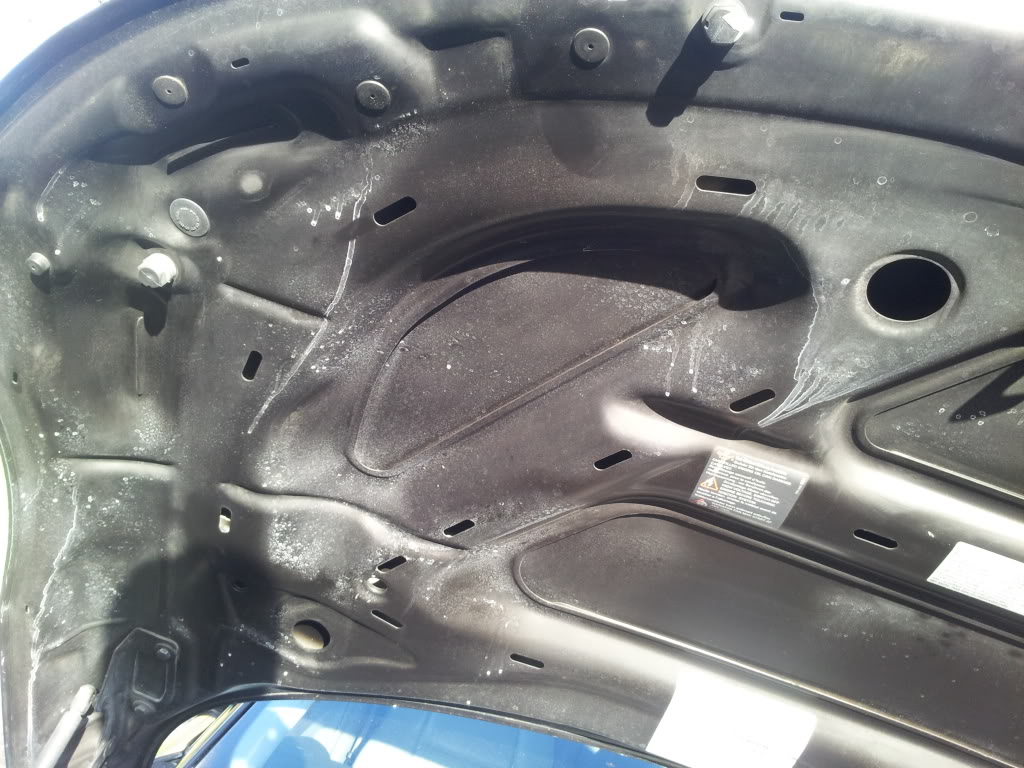

Thanks ECS. It doesn't matter if the heat/ac is on/off if that makes a difference. I forgot to mention some more information. Car has 123k, serpentine, waterpump, and timing belt were all changed at 100k and new alternator about a month before she bought it. She got it for $4500 which I thought was a pretty good deal, but now I'm beginning to wonder haha.
She can't afford the probable $1200 bill at the stealership so I got stuck with it haha.
Some pics.
Its somewhere in this area...
Could this mean anything??

is that the turbo side correct? i would think it might be the coolant line to the turbo that leaks but the amount that you are leaking seems to be more then a small leak. U cant hear or see exactly where its leaking when u drive the car hard and then park to hear or see the leak?
Old Oct 3, 2013 | 12:28 AM
tlorenzo94's Avatar
Joined: Sep 2013
Posts: 4
From: Melbourne, FL
Correct. The leak is quickly growing as a week ago it made a 200mile trip without needing filled, now it barely makes it across town. Anyways, my buddy and I tried getting it hot then opening it up to try to find the leak and we couldn't find Sh*t. We did this 4 different times and no success haha. And what makes me think it's something to do with the turbo is when it's driven harder it sprays more lol. I just don't have the slightest clue on what lines/seals/flanges it could be or how to even get to them. Thanks yall.
