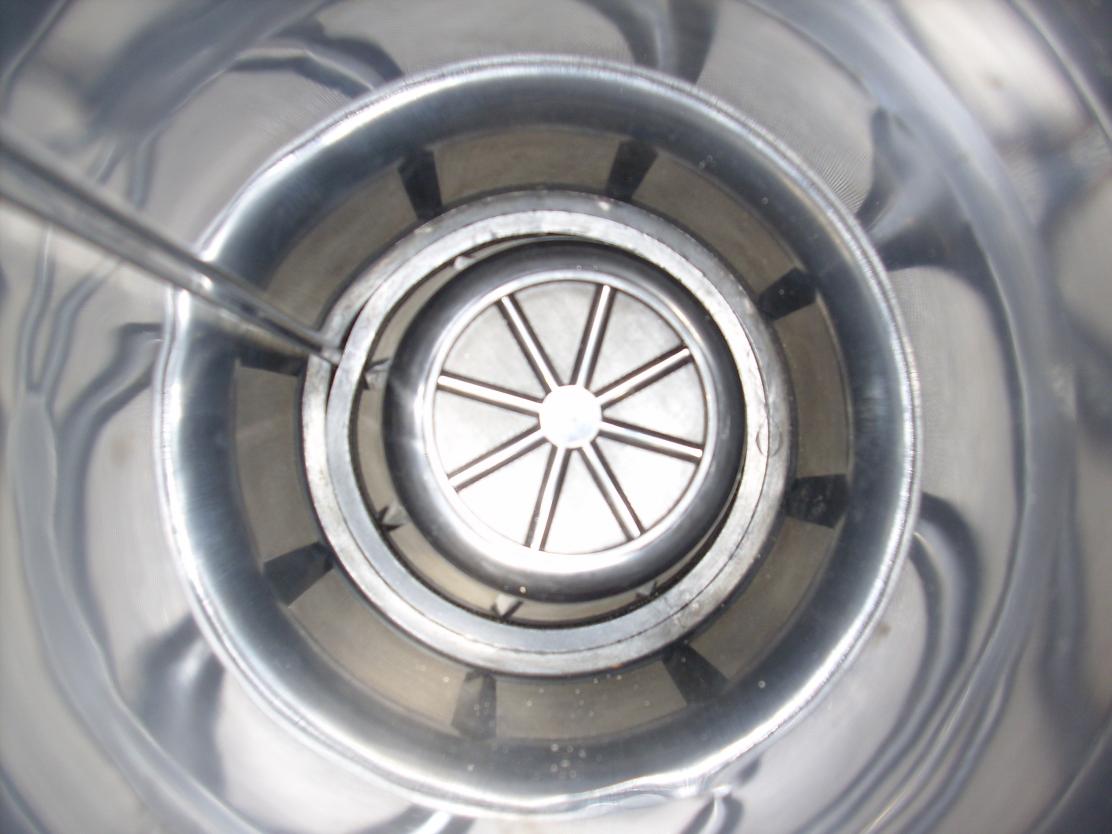

Or there is this,...

That picture shows me nothing lol. ^ thats what I was thinking, something like this... http://www.optionimports.com/aemdrairfias15.html
