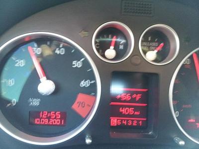

I recently bought an 2003 Audi TT, 180hp (non Quattro) with Transverse Mounted 6 speed Tiptronic Transmissions. The engine "appears" to run a little hot (Temp. needle one notch right of middle notch) after warming up. Is this normal?
When the temperature needle moves to the right of the middle marker then the transmission starts to shift with a heavy jolt (un-smooth shifts). Is the transmission shifting related to the engine temperature? Do I have a sticky thermostat or a bad Coolant Temperature Sensor?

you need to determine whether the temp gauge is reading correctly. you could also have a water pump that is failing. you didn't mention your milage.

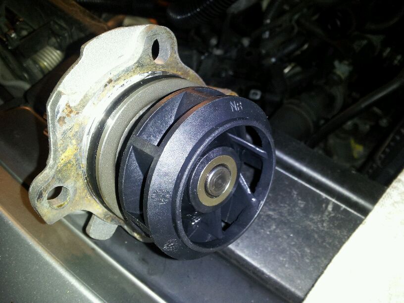

I pulled out the water pump, it has a plastic impeller, but looks like in very good condition. Impeller is fixed tightly on the shaft. This pump was installed in the summer of 2011.
Now I am really confused, thermostat is Ok and Water pump is also OK, so what could be the reason for over heating?

I replaced all parts related to overheating a few times. I think it may be the fault of bad aftermarket parts.. Who knows. The last fix that fixed it was the Fan Control Module. Could also be the fan switch in the radiator, or the fans themselves. FCM and switch are pretty cheap fixes.

Are you sure it is running hot? The most common cause of this is the temperature sensor itself. A $15 part that is easy to replace. Confirm the temp using the HVAC readout to confirm that you aren't reacting to faulty info...

Ok, so I installed a new timing belt. Then went out and bought a new infrared temperature measurement device from Harbor Freight and checked the engine temperature as the engine warms up. Looks like the temperature measuring sensor is bad. This is because the thermostat opens up just before 100 Deg C. Next project is to change the sensor and verify that this is indeed the case.
