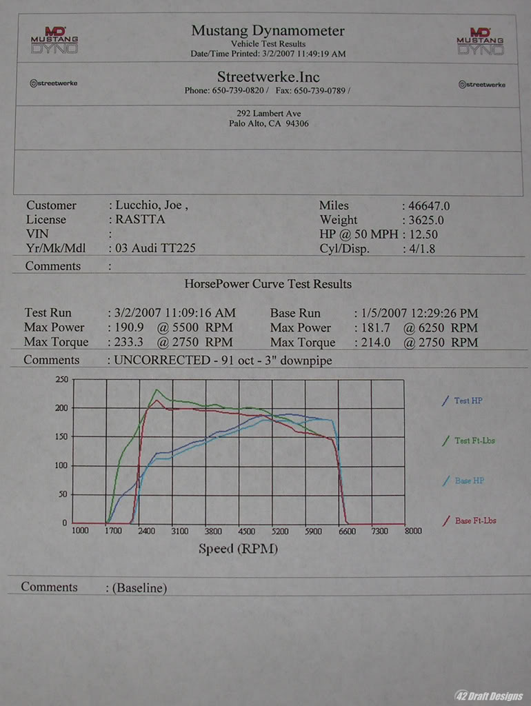

(Hey this is for Righteous) here is an actual recent dyno test for a 225q after the installation of JUST a downpipe, and they kept that stock Cat and exhaust. Thought it was pretty nice and the gains are ....well.... they are just plain sexy!!!!! I was lucky to just save the pics of the results, so im gonna have to just paste the pic on here, haha sorry!!

Tmoney,
So that dyno was completely stock except for a 3" downpipe?

WakeOn,
Hey sorry bout that, it looks like its just a base 180TT stock/w a downpipe. I read the chart wrong because the top of the page says that the model was a 03' 225TT. And theres not way he could be chipped because his base HP would be over 200hp. Thats just comin from lookin at the chart though.
Old Oct 24, 2008 | 12:30 PM
  #19
Tmoney's Avatar
Posts: 175
From: Blacksburg, VA
And yea, thats got to be totally stock, with the exception of a downpipe, but these other guys on here might think otherwise cuz they are more experienced techs than i am lol

I would have to say that is in fact a dyno slip from a 225...sadly those numbers are pretty spot on for a stock 225.
