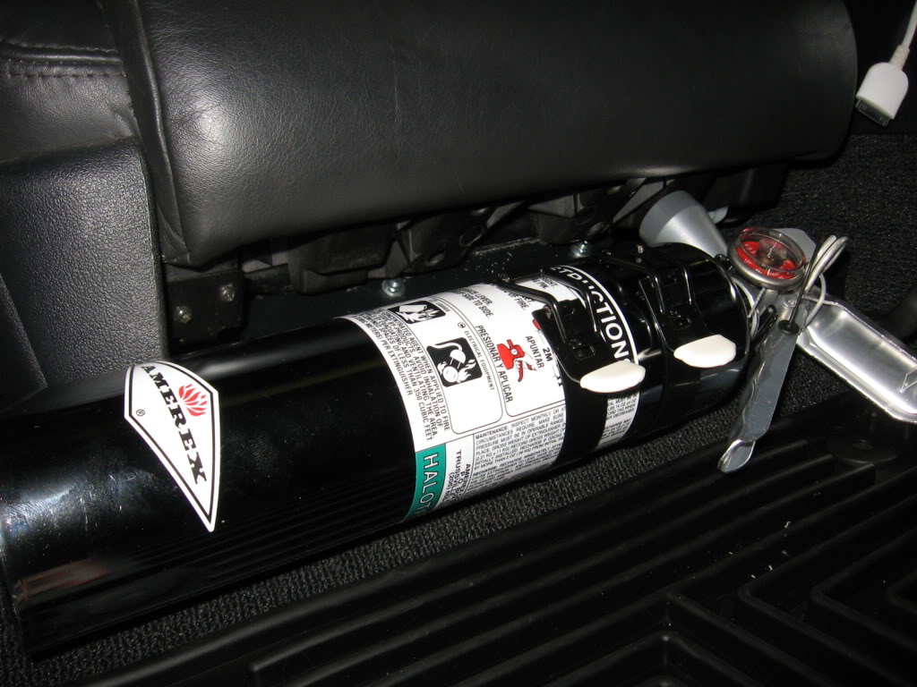

Thanks! In my case I need it within drivers reach - req'd for PCA track events. So I fab'd up a metal plate about 8" x 5", 1/8" thick and bolted it to the front, underside of the passenger seat. There's a metal bar there with 2 pre-drilled holes to attach to. It'll take a #8 bolt and a #10 if you open the hole a bit. To the plate I attached my fire extinguisher bracket.

Yup, this was the design I ended up using with some mods. Problem was though that the plate was touching the floor and restricted seat movement fwd/bwd. So I put a bend in the plate about a 1/3 of the way down raising it 1 1/2 - 2 inches off the floor. The height is now perfect but by putting the bend in the plate it effectively shortens the mounting points for the FE. Two pieces of metal extensions from Home Depot solved that problem.
