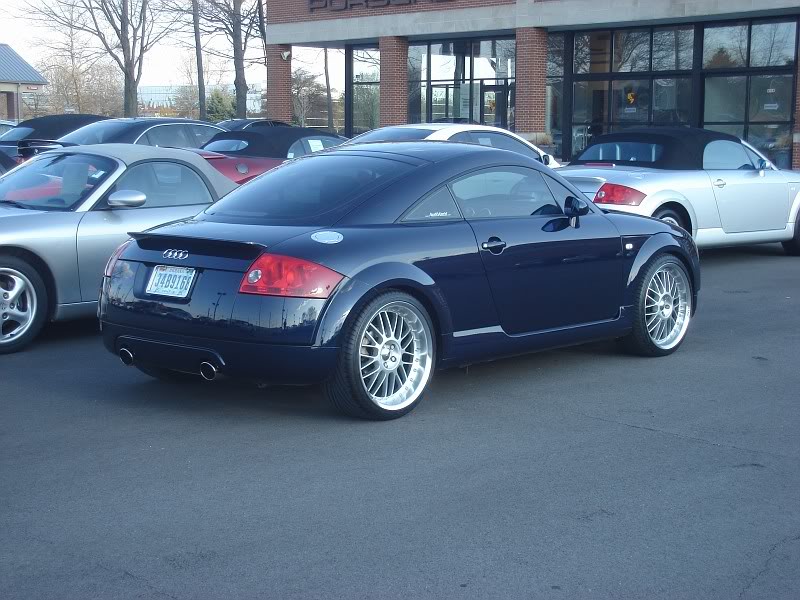

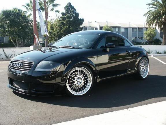

Hey guys, I just picked up some used Axis Supermesh (discontinued) 18x8 rims. Silver with no curb rash or noticeable damage at all (maybe some TINY scratches from a "bad" towel or something). I like them but I was wondering, what size tires do I put on them now? I'm trying to figure out a good tire size that wont rub but also looks nice with my coilovers (Bilstein PSS9's).
These pictures I found are 19's...

^ the last picture was my inspiration when i got my TT couple years back.
anyways, i'd run 225/40's
