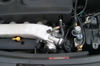

And here is how I repositioned the nozzle. I moved it to the top of the throttle body.

Default RE: Group Buy Water/meth
Is it really a noticable difference with the nozzle mounted on top of the TB?

I really can't tell and didn't take any kind of measurements before (and don't really want to switch it back), but I like posting pictures. j/k [8D]
It's just as I thought about it, the velocity of the intake air is probably greater at the point where the throttle plate starts to open than from the side where it's more diffused. I'm thinking spraying from the top will cause better dispersion of water, but I could be completely wrong. Maybe there are some fluid or aerodynamics engineers out there who can chime in, or some engineering students who need an idea for a class project.

Makes sense. Also no chance of water pooling around the orifice. I have a water only cutting head for the waterjet at work, blasts out a stream of water that looks like fishing line. Believe its a .004" diameter orifice, with 60,000psi of water behind it. If water splashes back at the head and drips to the orifice (lowest point) that strand of silk looks more like a piece of dental floss. Doesn't really make a difference on the jet, its still 60,000 psi, which is gonna cut regardless, but that illustrates the difference in spray pattern. A side or bottom mounted nozzle I'd assume could accumulate more water around the orifice, possibly ruining the atomizing effect.
