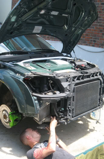

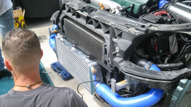

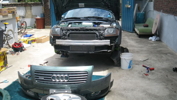

Found these pictures while lookin through old stuff. these are from my FMIC Install back in 07. they oughta give you an idea of how the bumper comes off... no close-ups of the mounting points tho... but I need to pull it again tonight... so if I do, I'll get some pics of the nuts, bolts, and Torx screws.
Enjoy
Bumper Removed for FMIC (Front Mount Intercooler) Install
Bumper and Crash Bar pulled... and Im removing one of the old stock SMICs (Side Mount Intercoolers)

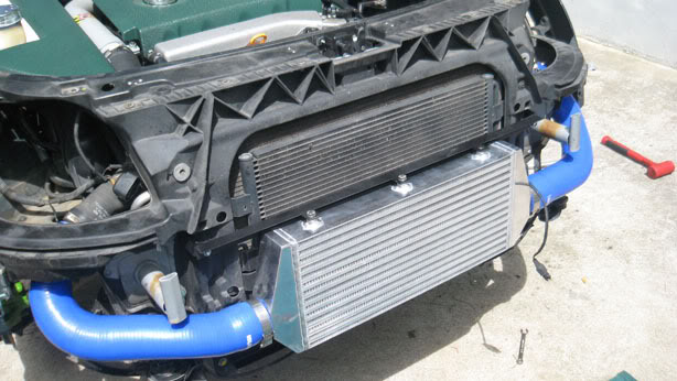

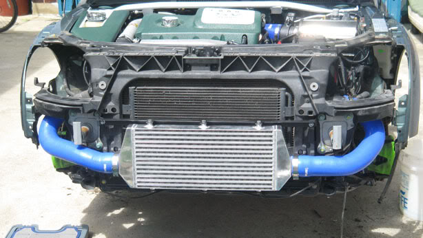

The FMIC Installed (Bumper still off)
Same Thing, Side View
Top View (Before I reinstalled the Crash Bar and relocated the OAT Sensor)
Sorry I don't have any pictures of the actual mounting points... but I need to pull mine again soon. Maybe I'll do it tonight. If I do, I'll snap some pictures of the Wheel Well nuts, the Torx Screws, the UnderCarriage Bolts, and the top Bumper Cover Bolts for you and post em up.

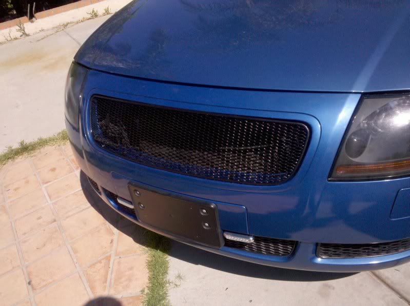

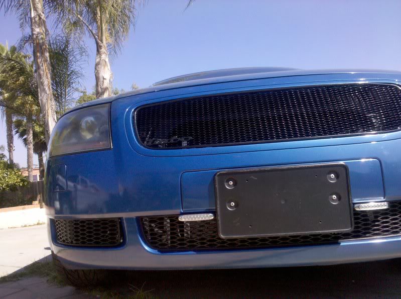

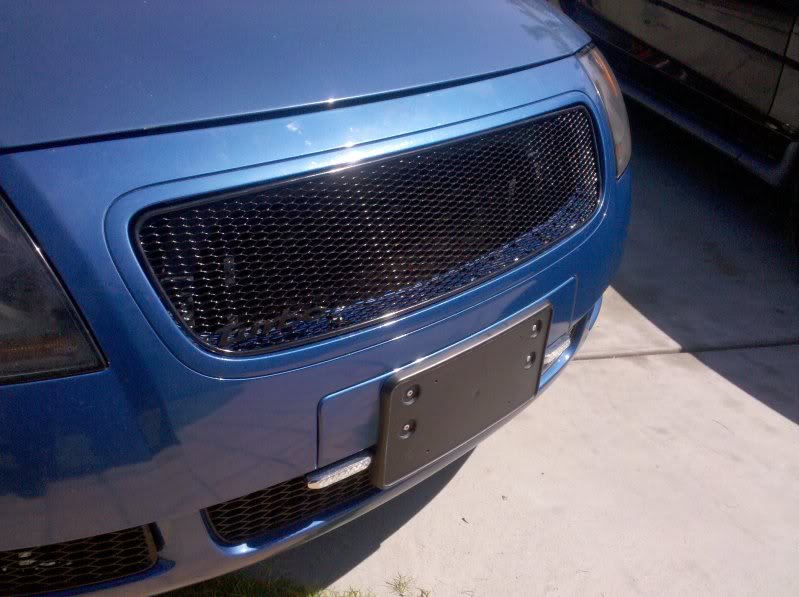

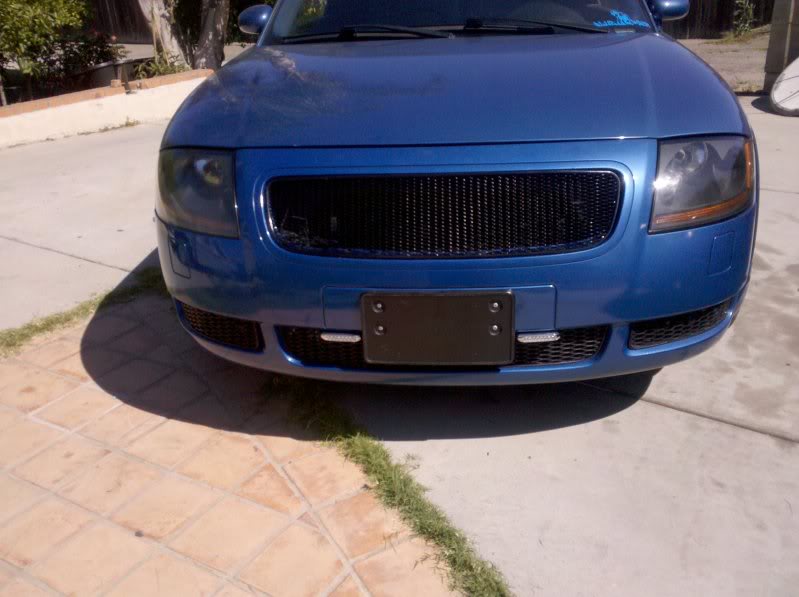

@neur0tic thank you for the pics they actually did help so absinthe does that stuff actually make u hallucinate or give you a high? well i installed it as best i could take in mind it is a ebay grill so it doesn't fit perfectly i did put a black turbo emblem on it but u can really see it because grill is black

Ok... on to the second topic. I'm actually impressed. From the daytime photos you've posted, I wouldn't guess it was a generic one size fits all eBay grille. Good Job molding, trimming, and fitting it; it looks great. Did you happen to take any photos during the fab-work? I'd like to get some pointers from you... and you should definitly make a write-up for this project... some type of step by step pictorial DIY write-up.
Good Job
Edit**
The real test though... wait until the sun goes down and take a few night shots with a flash... Real sunlight can wash out flaws; but artificial flash will cast enough shadows to reveal any flaws or unevenness if there is any. regardless of how night shots would come out... I still think it looks great. I would pull the Turbo badge though.... but that's just a matter of taste and opinion...
