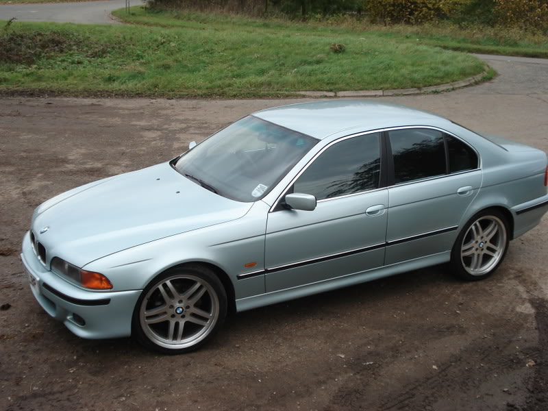

Yeah the hardest part when painting things that you cannot remove from the car is masking it, getting the paint and prep work into all the nooks and crannies, making sure you mask everything for over spray as it gets everywhere!...
Also i am not sure of the law or the paint mixes here in the USA, but the most prevalent in the UK is the two pack paint, which contains Isocyanates which are toxic so it is illegal to spray when not in a fully filtered booth...
However, it seems that most paints here are cellulose or water based which is good so spraying yourself should be fine. I used to rent all the gear from my local paint supplier over a nice warm weekend, i had a nice filtered mask and created a makeshift booth by using a very cheap wallmart gazebo thing, then wrapping painting dust sheets around 3 sides, the tops of which were perforated to allow air flow above the panels.
Here is one i made earlier... BMW E39 5 series, full front end, wings, bumper, hood etc...
One piece of advice i would give to you though from my own experience.... Put lots and lots of clear coat on in nice layers... this means that after a few weeks of it curing and hardening in the sun etc... you can get a PC mop and polish out any imperfections or mask them by giving a massively clean shiny appearance without cutting into the actual paint.....
A body shop quoted me $ 3-4,000 for the job, it cost me $200 in materials and rentals plus a weekend of my time and effort.
