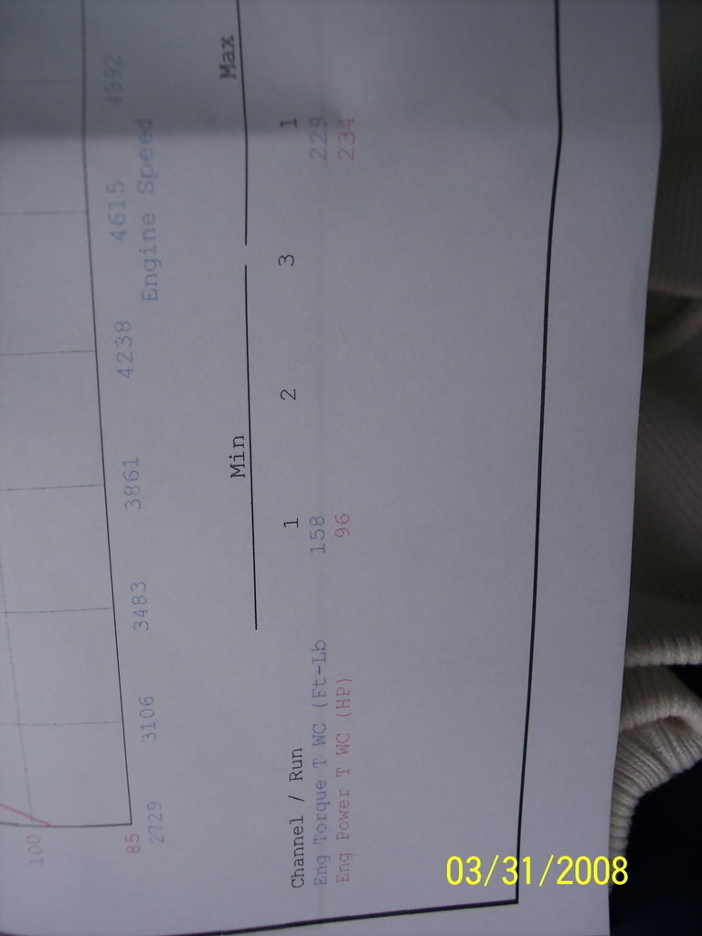

I thought they seemed high too the pulls were in 3rd and asfar as i know thecar isnt chipped.The 3" is turbo back as in custom dp too. I dont have a scanner but here is a pic from the digi cam. first is the graph second is the numbers and it was 229tq not 227. I edited it the original.

yeah, that dyno is worthless and the reason you dont dyno a TT in awd

THere is haldex waves and there is that. That thing far surpases the 5-15whp peaks and valleys like any other awd dyno. If it was done in fwd, you would have a nice smooth curve instead of what you got. The power isnt contant between the fronts and rears on the haldex and since its constantly changing, a awd dyno isnt all that useful. I know people like to have awd dynos, but no matter how you do it, your not going to have a clean/valid dyno.
But not to sound like a smart ***, but you didnt think that massive spike at 3100-3500 and massive valley at 4700-5200 is normal do you? Also that 3-5hp is a peak, i would love to see all 3 and compare them. I would bet none of them remotely look alike. They should of said something to you about it reading like that after the first run! [>:]

I knew doing it inAWDit would have spikes and valleys, so iwas expecting the spikesand didnt think anything of the big spikes at 3100-3500 and massive valley at 4700-5200(this is the first car i have ever dynoed so i didint really know what to look for) i was hoping the garage knew what they were looking for. As far as the other 2 go there practicallythe same, spikes and valleys in same areas. Oh well ill take it back and get it done in FWD and see what it does. Give me 2 weeks to get up some of the extra cash. The main reason for this was to get a baseline before some other parts go on.
