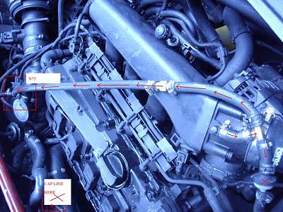

At your own risk of course.And dont even dare try this without using vcds, all im going to do is show you a way to make the little 1.8t a bit stronger at all rpm ranges no matter what state of tuned condition it is in. after fooling around with a bunch of different fun ideas just messing around, i came accross a method that requires 2 ft of 1/4 inch vacc line, 1 bolt,10mm open wrench,vcds and a brass T.I strongly encourage the use of the stock n75 with this by itself with no mbc or other junk. And yes, my engine bay has seen better days in cosmetics.

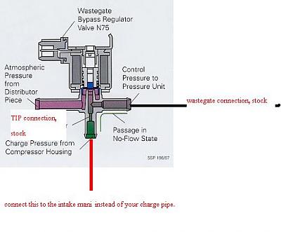

A method that alters the n75 charge pressure line by attaching it to the manifold instead of the charge pipe post turbo. Increased vaccum inside the intake mani alters the wastegate in such a manner as if you upgraded the spring pressure inside the wastegate. so, much more quicker smoother boost down low, and lasting alot longer up top.~30% increase in power ish.
the 10mm wrench is used if you need to adjust your wastegate spring loose to adjust the boost down a little bit after. ie,if its so strong that you get limp mode. use a bolt and clamp to cap off the old charge pipe n75 line. T the new n75 pressure line off something like the evap line in the pic.
what it is:

I really doubt it's "30%" more power and torque. But the DV response is better. I'm running a "T" at the manifold and another one between the n75 and the DV. So they are both running off of the manifold vac.
