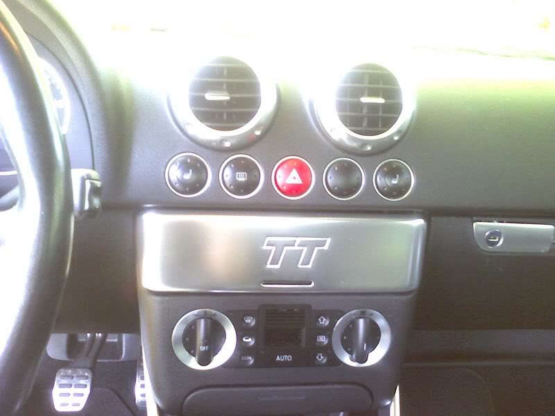

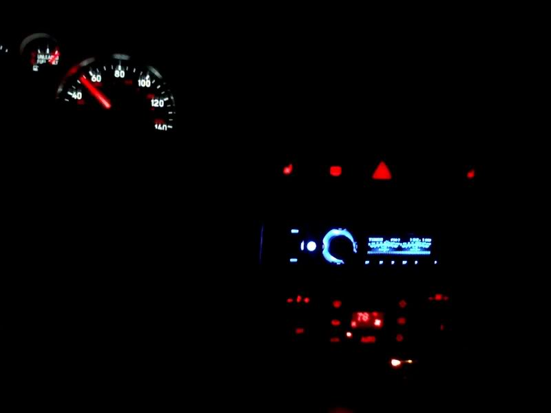

Got the new headunit chosen and installed finally. Went with a pioneer unit. 7 band equalizer, bluetooth, mp3 wma aac compatibility = wayy cool. Here are some pics...

Sound quality is transformed over the stock headunit. Still planning on upgrading the stock speakers, but the difference nowis amazing to say the least.

I did install it myself. Total time was about6 hours with 2part runs included. There is a harness for the stock amp. Metra 70-1787 is the part #. I got mine on eBay. There were lots of them on there.The stock Audiheadunit uses preamp outputs to the Bose amp, not speaker level.Makesure that when you hookup the preamp connections from the headunitto the harness you puta "ground loopisolator" betweenthe twoto eliminate the loud pop when changing any settings or sources. $19 at radio shack, cheaper on eBay.The hardest part was getting all the wires back inside and the headunit in place. If you notice I also had to put the headunit behind the bracket in order to get the door to close. In the third pic you can see the little mic for the bluetooth aspect of it. Works quite well actually :-)
