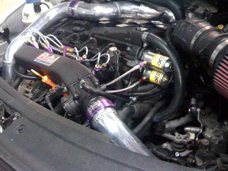

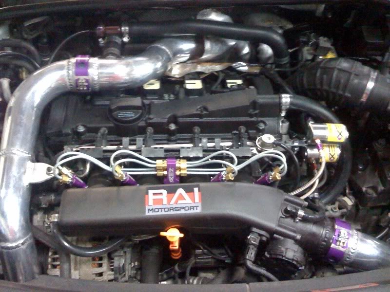

this is the stuff we did to my tt for h20. unfortunatly saturday i had to abandon the car on 65th street because of a failed crank position sensor. but i got it to the show sunday but didnt see any of you guys that day. so here are some pics.

Man, you guys sure arent spilling the beans on his car.... you suck! That is one expensive ic piping, but i guess no blow couplers is a good thing...LOL

NOS is a brand, that is a ZEX direct port nitrous system. If you sprayed liquid nitrogen on the ic, it would crack. You spray either nitrous or CO2 on it. Both are costly and its better to just run water/meth injection than spray the ic

anyway not much there, 100 shot of nitrous, purge through the ic. bad *** intercooler kit and 3 inch turbo back exhaust..flared to 4 inch stainless for the tips. and the wiggins clamps are bad ***. i welded the intercooler core to the bumpers rebar support. so to remove it i undo two wiggins clamps then unbolt the rebar . and last the tree hugger delete. removed a box full of vacuum lines, check valves, and emmisions crap.
anyways we waited until the last minute. I was hoping to get chris's car done instead. so no time for bt.
