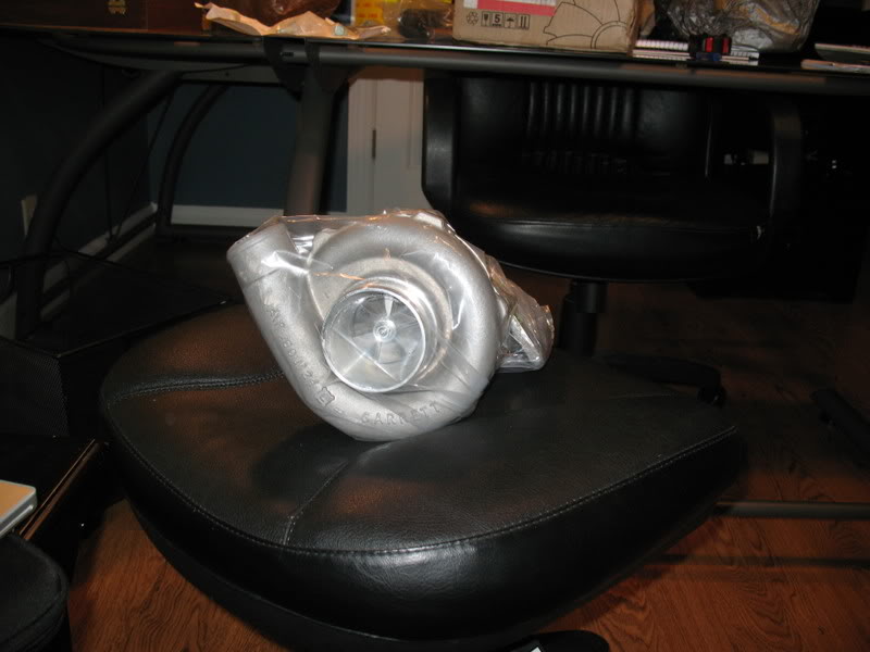

As for the turbo, the kinetic turbos are good, but if you spend another $100, you get a garrett 50trim which should last longer overall. If you want to spend another $500, you can get a dbb turbo like a 28rs-3071r.

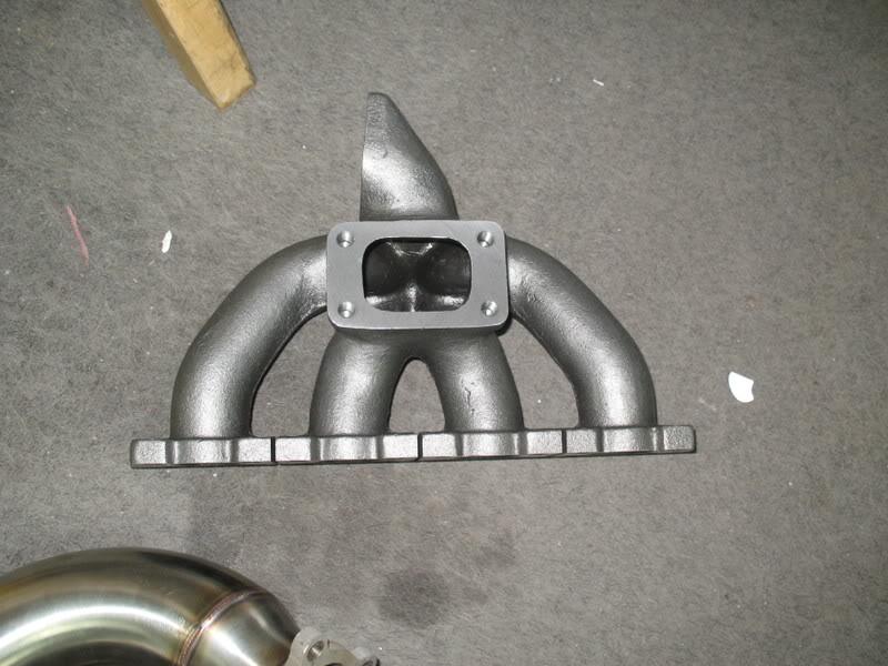

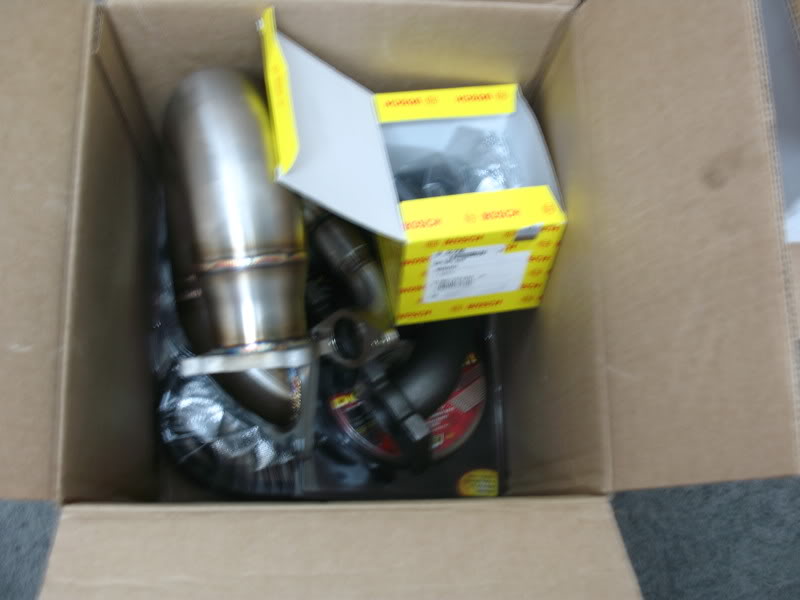

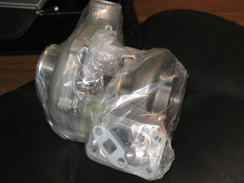

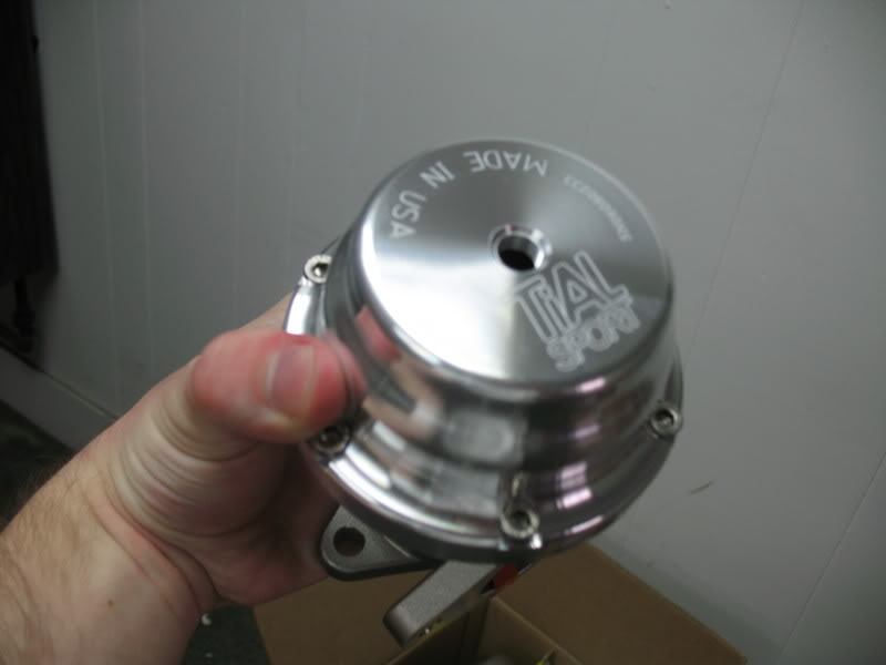

Ok here are some pics, my camera is not the greatest so the quality isnt to good.

Arnolds kits are great. The best thing about his is you can get w/e your hearts desires. If you want a t3 or t25, .63 .64 .82 .86, hks or tial housing, and even different trims of turbos. The only down side to his kits are you have to wait a little longer if you dont have fwd since he doesnt have a bunch of dps for the 180q or 225.
