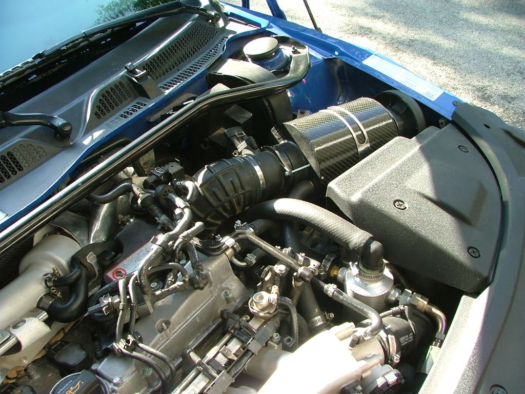

Here is a pic of my set-up:
You need to run a hose off the block breather and the valve cover, and then either vent or run the blow-by into the TIP (like stock)
