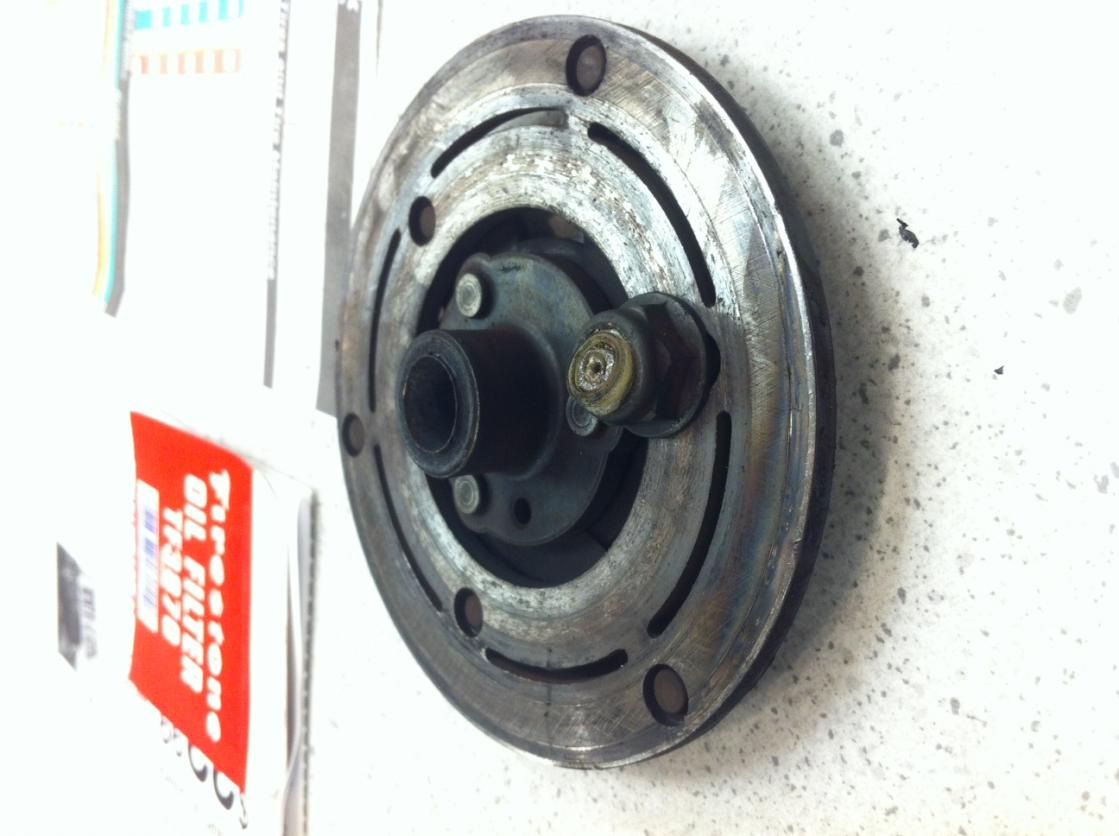

Car was due for service so I took it in and had the oil changed and aksed them to read the CEL. When they read it, I got the P1136 code. Also, they told me that when the removed the plastic underhousing, the A/C clutch was sitting on the top of the plastic housing. I have attached a picture of the A/C clutch to this thread. I talked with a friend who said that the two issues were completely unrelated.

2) How should I resolve the A/C clutch issue? I'm unsure if I need an entire new A/C compressor and clutch, or if I should simply replace the clutch. I've hunted around on the web and can't seem to find the part number for the clutch. At present this is my daily and I want to get this fixed ASAP but am unsure of how to approach the issue, and what I should reasonably expect a shop to charge for this. My friend (hobbyiest mechanic) also told me I should replace the accessory belt as well.

as for your A/C thats pretty nasty, definitly replace your accesory belt, and its on you if you want to replace the whole a/c. I will add with that milleage i would brush the teeth on all your pulleys when you do the replace, this will get rid of any deposits that will start any really annoying pulley squeeks

I got a quote from a shop, $1,436!!! They said compressor has most likely seized ($550 part), and will need new belt, A/C recharge (1 hour labor), and a couple other parts.

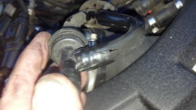

I did the vacuum leak test and there certainly was air coming out of a tube under my manifold, im getting a smoke machine to isolate which tube it is, they certainly cram alot of tubing in these damn 1.8Ts.

All youse guys have probably solved your 17544 problems by now, however after a lengthy study of the problem with this code I discovered a couple things. 99% of the time this code is caused by a leak. I do see where one or two guys solved their problems with either a new or cleaned MAF, FPR, injector, etc, but it is most likely a leak that you can not find by pressurizing the intake system or listening for a leak. Pressurizing the intake and pinching off the breather line does not check the large plastic breather elbow that plugs into the lower part of the block (10 inches below the intake manifold adjacent to the oil filter manifold) behind all the other hoses and is nearly completely hidden from view. This $25 elbow cracks with age and heat and allows unmetered air into the intake and is part of the air breather emmisions and can also, but not always, throw a 'secondary air incorrect flow' cel. It does not usually cause a bad idle and if you can reach it with some starting fluid spray or carb cleaner spray while idling it will cause a hint of an idle change, but only a hint so you have to be very diligent when doing that. It is very hard to detect but is the source of most of the 17544 code problems when that code is the only persisten code with no other codes (exception to secondary air flow noted on occasion).
Found this crack in one of the 'hard' vacuum lines under the intake manifold on my 2001 TT AMU engine with an 1136 trouble code. Put some electrical tape around it for now until I can get all the parts to replace the whole mess.
