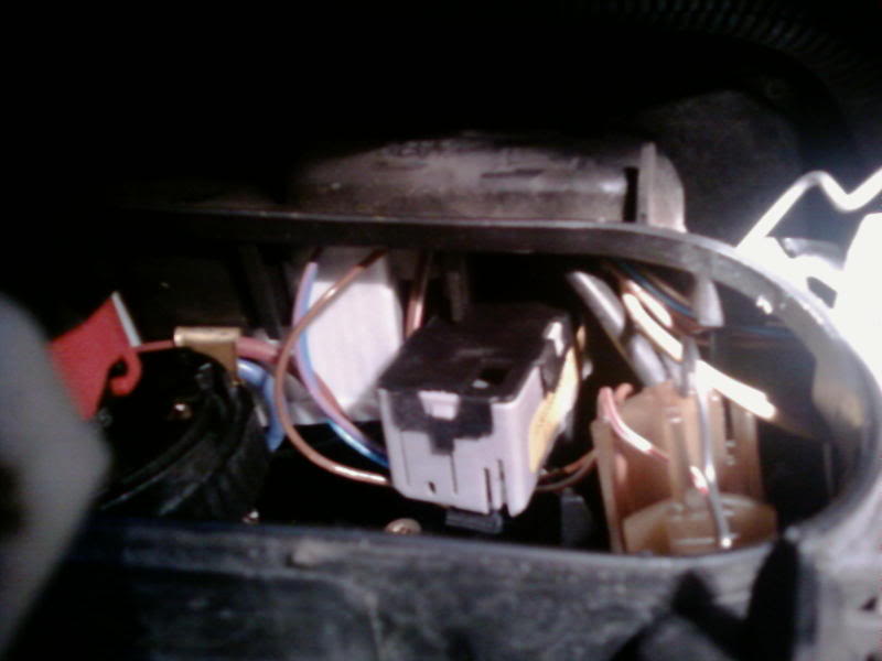

I cant for the life of me figure this out. I have searched but am still having trouble. The audi cd that I have says this it is the bottom part of the tan piece that’s on the left. (with the metal clip) when I took it out, there was nothing there, nor could there be.
Here is a picture…
it’s the passengers side.
2001 tt 225.
Where is it and how do I get it out…? Twist turn pull….
I do not want to brake anything

If I remember correctly, it was just twist and pull. I can't remember if it was the tan one or not. Try pulling it out of the otherside, because I think you may be missing your bulb.

It is the one with no wires coming out of the back. Twist and turn. Mine was very hard to get off so I gripped the handle with some pliers and turned. It is the Greyish one torwards the center of the vehicle. From the pic looks like you are in the wrong one. You should be able to see the greyish "turn ****" by just looking in the area with the hood up. You shouldn't be undoing the metal retaining clips.
To make sure I am describing the proper light I am refering to the one that lights up the amber strip below the head light.

I know that the “turn signal” and the “parking light” are two different bulbs. I cant figure out how to replace the parking light.
The gray clip that twists off, on the outside of the above pict and towards the center of the car, cant be it. it is too high. I think that that one goes to the round circular buld in the top left corner of the headlight.

where is the light buld in the amber section...??? in the center of the amber bar. towards the center or more to the side of the car....

I told you where it was already. Please see below. AGAIN....If you are refering to the amber strip at the bottom of the headlights that is the one....behind the gray cap.
