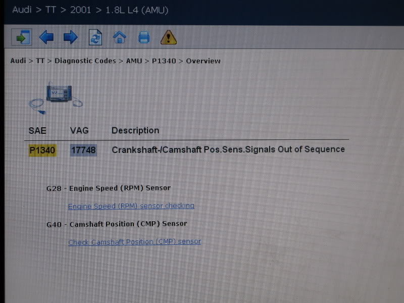

Default RE: Shes OUT !!! Yay

sounds like trouble mine threw that code and it was a stretched timing belt[:-]

ORIGINAL: .clipse
hey beks, instead of actually taking a picture from the monitor
you can always alt + print screen and copy paste the image to paint and save as .jpeg
works wonders in throwing up FAQs/Guides/DIYs
Unfortunately the Bentley manual will not install on my mac.
So I have it installed on my POS laptop, which isn't connected to the interwebs.
Taking a picture is my only means to transfer the info.
Actually... I do have a USB drive... Maybe I'll transfer it that way from now on!
