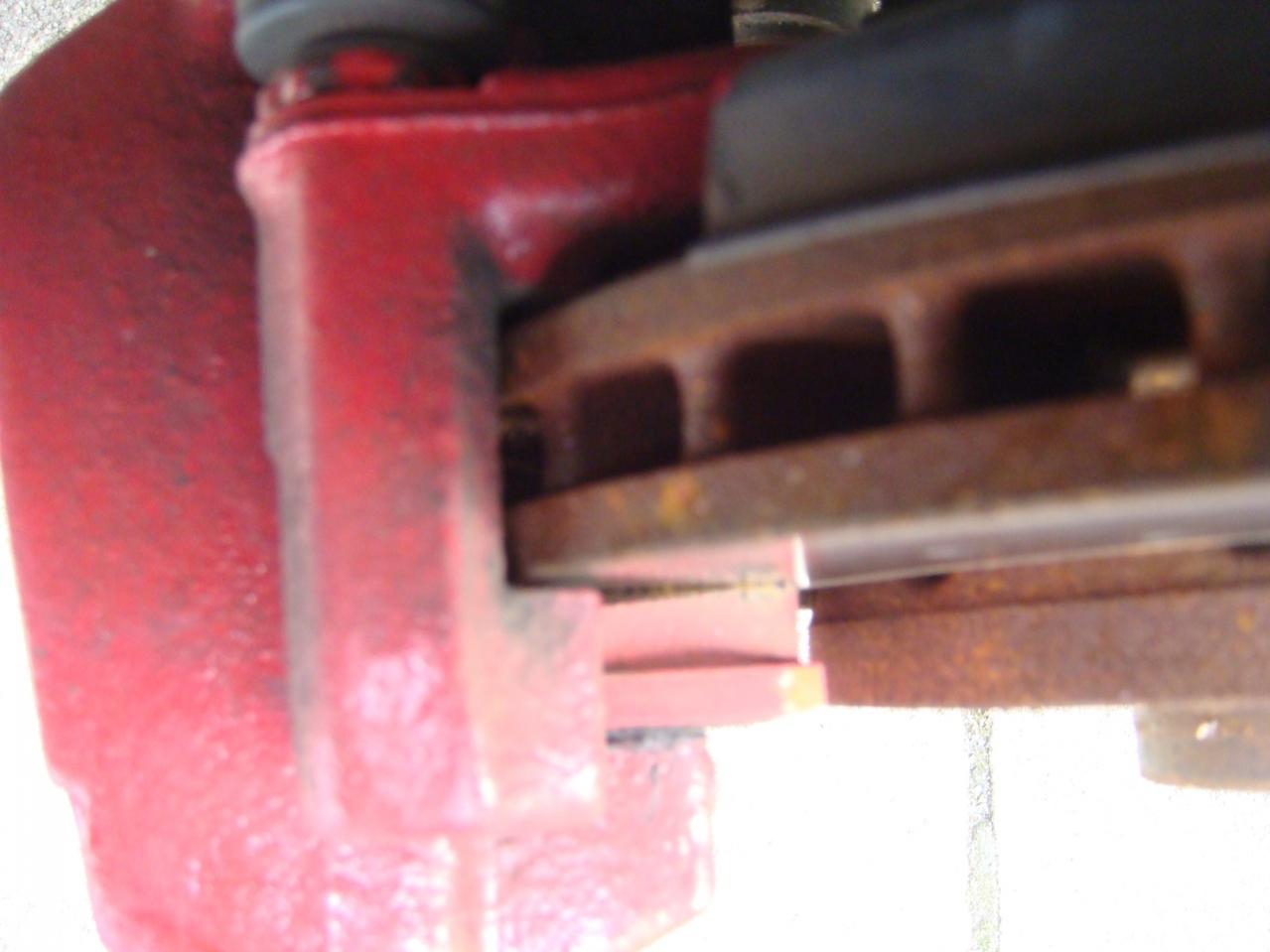

I just rotated my tires front-back, back-front and the noise still occurs. It definitely sounds like the brakes/rotors and it occurs non stop while driving straight (especially noticable when driving down narrow streets with cars parked on both sides). It sounds like it's coming from the front driver's side wheel and it's like a tap, tap, tap, tap (as the wheel goes around).
A few months ago I just had the brake pads and rotors replaced by an independent reputable Audi shop (not the dealer). The front pads that I bought were "Hawk Performance HPS" and the rear are "EBC Redstuff Ceramic 3000".
Is is possible the brake pads are too close to the rotors while driving and not pressing the brake? If so, is this something the shop can fix quickly? (is it going to cost much?) I just got laid off so I didn't want to go to the shop in case they end up telling me it's going to be $100+. The rotors are crossed drilled (and have completely rusted arrrr), so that may also be causing the issue if the brake pad is rubbing against it, but it's weird it isn't all the time, it's just when the wheel is at a certain spot.
I took a pic of the rear passenger side brake, which looked a bit close as well. What do you think?

Attached Thumbnails Strange noise while driving after rotating tires-dsc05265.jpg
