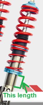

Hi.
I am thinking of getting Vmaxx for my Audi TT 1.8T 2000.
For those who have Vmaxx, what's the height you guys have it set up?
Please let me know for Front and Rear.

Originally Posted by kennyk
Hi.
It's nice to lower, but I never want to scrape any part of the car against ground.
Thanks,
Ride height for one person may not work for another, all depends on the conditions of the road around where you live.
Probably safe to set it up with about 2 fingers of wheel gap. That is, if you poked 2 fingers into your wheel well, the bottom of your fingers would touch the top of the tire, and the top of your fingers would just touch the fender.

^im at about 1 1/2 fingers of space. A little more in the front than the back.
And yes, coilovers are really the only way to go. That's the only way you'll be able to dial in yor ride heigth exactly where you want it. I've done the spring/shock route, and I wasn't happy. Either save the money for coilovers, or find a nice used pair on vortex.

Thanks for your replies guys.
Yes, I am sure it's different by cars setting and environment the height changes. Still, it would help me for my reference to know.
Could you possibly tell me how much more room you have for lowering spring setting (in inches or cm), rather than the gap between the top of tire and the fender?
Because I want to keep the adjustment as minimal as possible, and it would be easier this way.
Please see the attachment.
Thank you,
KennyK
