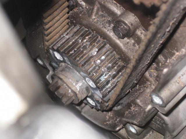

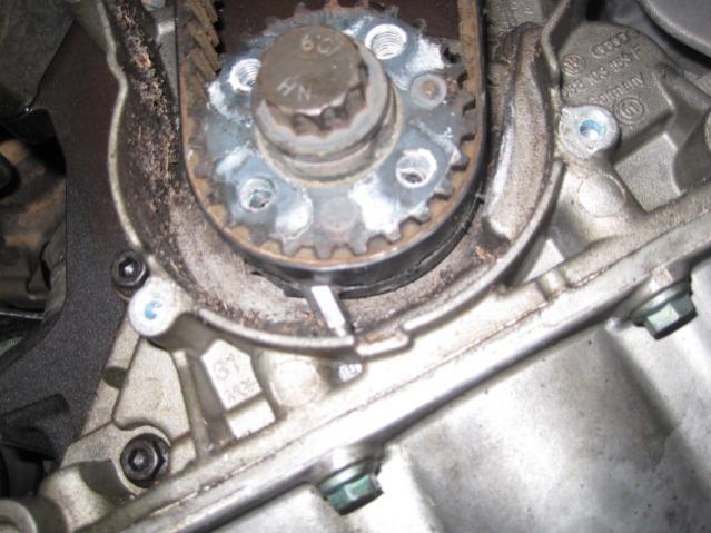

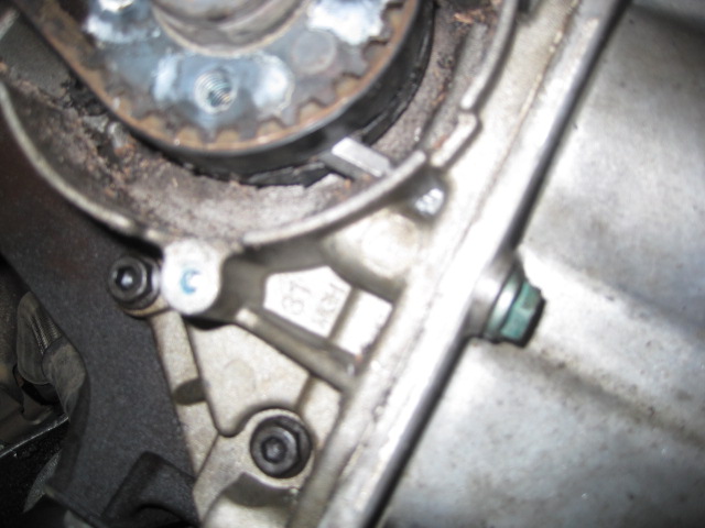

This is a new thread in reguards of the previous timebelt scratch, engine seize? thread.
So after opening her up, a bit was found lodged into the block case and crank pulley from trying to start the engine while the bit was inside the covers.
This sucker will not come out no matter which way i turn the crank pulley.
thing is, I have to replace the belt, so i have to align the TDC. and this thing wont let it happen. Need to figure out how to getit out of there before i can replace my TB. also i found my crank pulley teeth have been damged so now i have to replace that too
i have to break the bit i guess, without breaking the timebelt some how. and replace the pulley...
I'm not sure if i can do a crank pulley change, any advice??

Have you tried a flathead or chisel with a hammer to turn the bit till it rotates out? I hate to sound cheap or lazy, but the looks like there is enough meat on those gears to keep the belt in place, however it would be expensive if it failed.

Its hard to see but it actually blew a tiny hole in the bottom part of the block, its wedged inside the little oil pan crevice and the gear. if i go clock wise it gets stuck and strips the gear if i keep turning, counter clockwise it gets wedged completely and i can turn it, ill figure something out. no matter what, the bit has no play what so ever
I thought the same thing about leaving the gear, but the metal stripped kinda upward, i dont want my timebelt to get any extra stress no matter how minor.
the gears are only $25, but im clueless on removing or installing them. i know theres a tool to hold them in place to remove the crank bolt but its $50 and thats yet another pinch. plus there might be a chance you have to go all the way into the block.
If i have to go into the block, fug it, ill leave the gear and file the teeth down. wish there was someone to explain how to get that gear off
