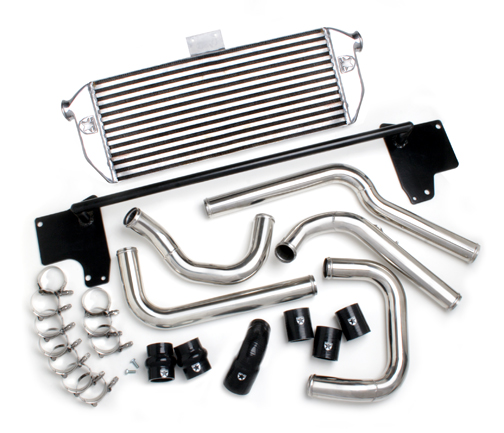

You have a map sensor, you need a bung for it to be mounted in between the ic and tb. Aluminum is better since it is light and doesnt hold heat.
To go drivers side, these are your bends
and will fit like this
You can just buy those EJ pipes for ~$350 and get yourself a good core 31" long and 3-3.5" deep and be out all of $600 for everything. Those are for the 2.5" pipes, im sure the 2" street pipes will be a little less if you dont plan on more than 300bhp
