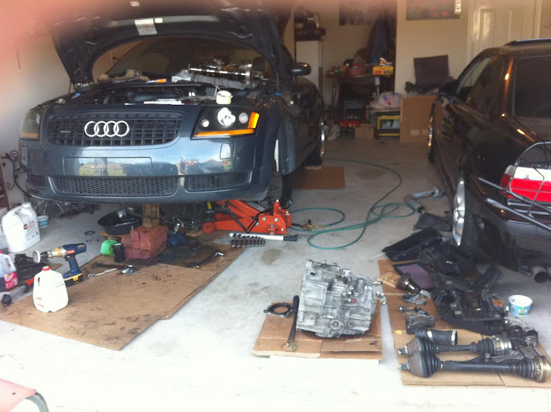

Replacing clutch, too? How difficult is that task? How many miles did it last?
Good luck
Good luck
Replacing a clutch is not as hard on TT's than other quatros. Id say it's easy. Just gotta gather all the tools at first. Then during assembly you want to get a list of all torque specks, and all parts as well. The hardest part is to place the trany in place. But it's probably easier if you have a transmission jack. Everything else is cake. Not only the clutch, I am also doing my boots.
