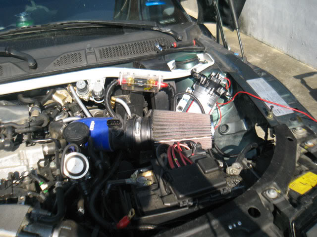

Couple pictures thus far. As stated before, Day one was 90% just looking for a spot to mount it all. Had to do a ton of modifications to free up space for mounting.
Here ya go:
Removed VTDA to evaluate space for mounting
Notice the small 90 degree bracket just under strut tower. It got removed shortly after to open a flat surface there for the pump. (two rivets hold it in.)

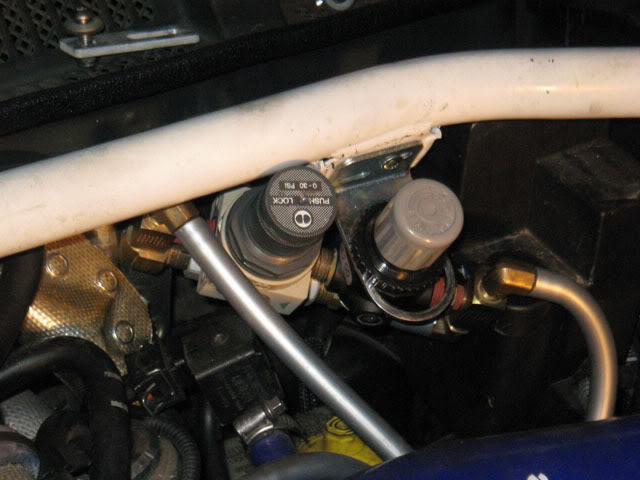

Boost Machine relocation. Used a self tapping screw to secure the BM mount directly to the strut bar. (did NOT drill or screw through the actual strut support, just the stabilizer bracket). BM is 200% more secure here also, much less flimsy as there are less brackets attached to each other.

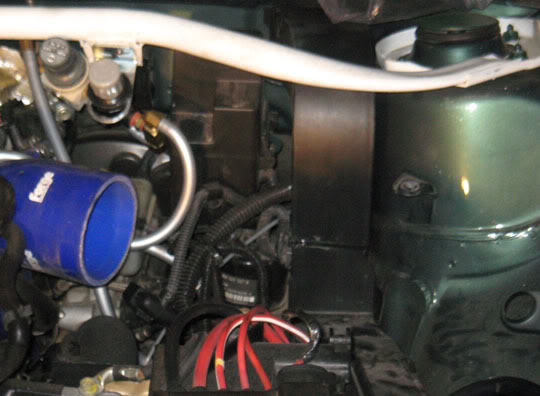

Small brack that the stock airbox mounts to on the lower right (just bent it over for now to make room.)
90 degree bracket from previous picture is removed. drill out 2 rivets and pryed free. will sand and primer to prevent corrosion (some scraping from pry job but oh well, I'll blend it out when sanding)

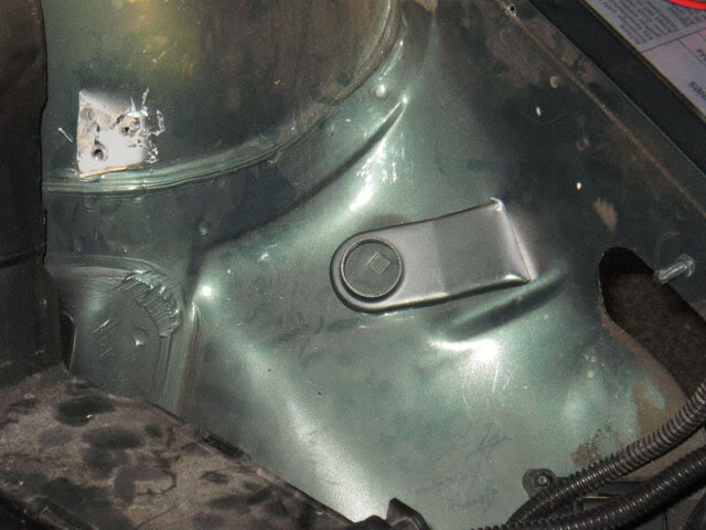

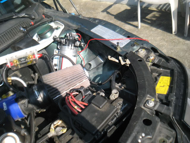

This picture is very deceiving. Pump is mounted on strut tower. looks like the elbows stick up above the strut tower, but they do not. They can be adjusted to point down anyway. Cone air filter was reinstalled without the VTDA housing (sounds soooooooooooo much better without the housing. Plus the blow-off (DV) woosh is 150% louder than before, not sure why lol. Empty space between battery and pump is for the resevoir. It will mount on the outer drivers side wall facing in to the eng bay. Fits well and there's a small channel right below it for the tubing to be routed through. Had it not beed for that pump thing inside the passenger side fender, I would have cut an opening and had a matching resevoir on that side like the one for the WW fluid. no luck though. There are surprisingly alot less places to mount this stuff than I originally expected. Two SMIC cavities and neither of them would accomodate the pump. Pump and resevoir are almost exactly level, hoses will run beneath them. I will still be using the solenoid upgrade however.
More pictures to come as progress continues tomorrow.
btw... that 0gauge fuse holder box ziptied to my strut bar... is temporary. I put that there because i needed to get the car into a drivable state in a hurry. THAT will go in the driver's side SMIC compartment.
