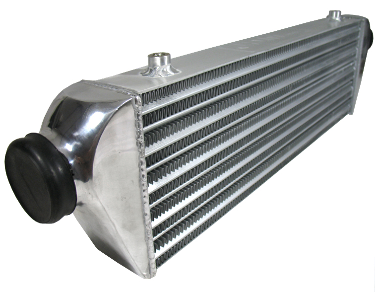

bar and plate design over tube and fin.
If your ebay shopping, and the ad says '0 pressure drop!' its because there are no damn turbulators inside it for the hot air to transfer the heat to. Bad IC.
Comparison. You can clearly see which has more internal surface area to remove heat. (and if you can't, the bar/plate is on the right)
You can get sorta technical about it all with end tank design/flow, and pressure loss, and crap like that, but it doesn't matter so much unless you're custom building your entire car, and few do. So, most bar/plate IC's will be fine. Check out what APR or someone is offering for sizes for your car, and base your buy off those dimensions. They've already done the hard work of testing what size core works well for the application.
