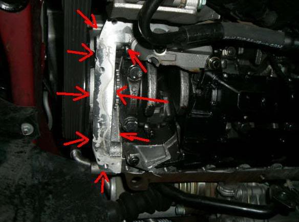

Hello, does anyone knows the name of this part (under the engine, oil pan removed). Is attached to the engine block.
The car is a 225 Audi TT, 2001.

Are you talking about the baffel?
That's the only thing I know of between the oil pan and engine...

no, not the baffle...
i think is the number 11 on the diagram....

Here is the first part of the part numbers, you are probably looking for #10 Sealing flange

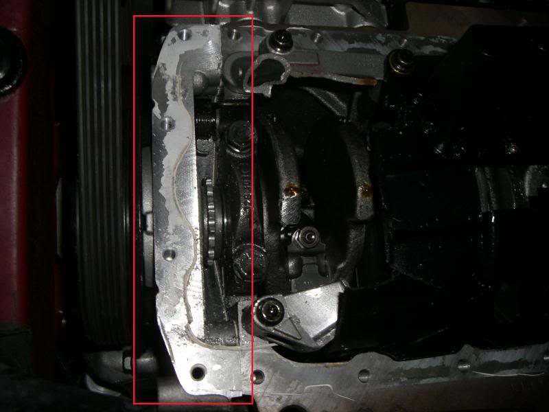

thanks, but the thing is that in the diagram, i´m not sure what part is... heres another picture....

Hard to see what you're after. Does it bolt to the block? Sealing Flange or Oil Pump?

yes, it it bolt to the block.
the thing is that the chain came off the oil pump due a hit on the oil pan, and cracked that part, the one i need to replace...

#10 has to be it, I went all the way through the engine section of the ETKA, and that is the only piece that shows as bolting to the block in that area. #11 is a bolt.
