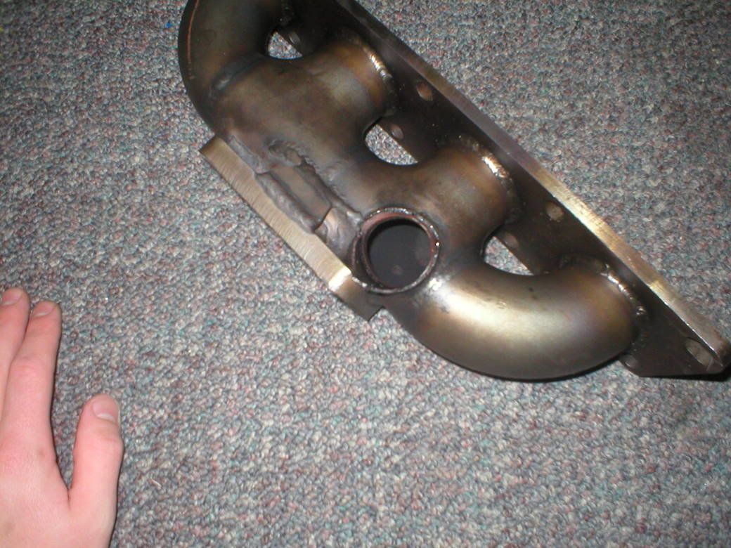

ORIGINAL: 1.8TK3MP
and what about he ebay tubular manifolds?
HAHAHA... umm... what do you think? HAHAHA get one and let us know what happens... I can tell you most people here already know what will happen but you can find out for yourself.

haha this is what happens with ebay manis

ORIGINAL: 1.8TK3MP
so we need a fuel pump for 630cc injectors?
no you need one when your fuel system is operating at a higher psi than your stock pump can deliver
and what ebay tubular manifolds? if your talking about the exoticspeed or obx, then no those are crap. ANY manifold made from 304 stainless steel is gona crack. and if the welds aren't fully purged those could break too. with a tubular manifold you should be using 3.683mm thickness.
the manifolds i've listed work really good and dont have problems. stick with them
