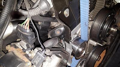

Ohh...100 Celsius is about where I am at with the 200 Fahrenheit. On my '01 2.8l. There is a bleed screw on the front to the right (looking at the car) of the power steering pump. Between that and the timing belt covers. It's a black pipe and the screw is either a 5 or 6mm hex head.

I had a good look but couldn't find any other bleed screws so far. 200 F. is 93 C., sounds like pretty close to the ideal operating temp, my gauge just has 90 in the middle (Germans use Centigrade at home) so I imagine that's the temp they are looking for. Do you have a photo you could send me? Today's very gentle test drive (about 2km total) from initial 90 degrees C. saw it steadily climb to 100. So I haven't fixed it yet.

Here it is on mine. On my scanner that I leave plugged into the OBDII port to check some sensor data (not a vagcom, that's on the list of things to get). My coolant temp pretty much always reads 204.8 F. Sometimes if hot and running AC it will go to about 208-210F and drop back to 204 when cruising.
Attached Thumbnails 1998 A4, 2.6 V6 Still Overheating, after changing Thermostat, Water Pump, timing belt-20160609_221247.jpg

Some reason that pic is kicked to the left. Needs to be turned to the right.

Thanks for the photo. Took me a while to get my head around it, but I recognised the water pump pulley and the fan pulley. I had a really good look all around that area, and it looks like my 1998 2.6L doesn't have this bleed point. In fact, there is no metal pipe there.
I'll do some more research on coolant bleeding proceedure for my model of engine, I reckon air locks are a likely culprit. The small return hose still doesn't return coolant to the header tank.

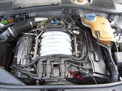

I'm having similar issues. My 1998 2.8L 30v suddenly started overheating and I replaced all the usual suspect components, and still overheating.
BTW,
The 30v front bleed screw is shown here in this photo:
Attached Thumbnails 1998 A4, 2.6 V6 Still Overheating, after changing Thermostat, Water Pump, timing belt-audi_bleed1.jpg

Hi and thanks for the photo. Sorry to hear you're having overheating probs, but glad I'm not alone. My car is different from yours - my bleed screw is at the back of the engine, on a similar level. If you hear of anything that sorts your problem out please let me know. I haven't ruled out the possibility of compression escaping from one of the heads and making an air lock - the old trick of looking for steam bubbles in the radiator doesn't work here, as there is no radiator cap, and the header tank comes from the bottom of the radiator.
I'm considering drilling a hole in a big juice bottle and plugging the small return hose into it, filled with water, to see if any steam bubbles are coming up. That's pretty close to the top of the radiator.
I'm waiting for my next trip to town to borrow a compression tester and/or leak down tester to look for obvious compression leakages from one of the cylinders.
I disconnected the 2 heater hoses from where they attach to the heater connections in the firewall and ran hose water through both - each of them makes the header tank overflow, so I assume there are no blockages in the pump's in and out pipes.
Another thing, does your header tank have an overflow tank as well? My header tank overflows directly down onto the exhaust, which is strange.
